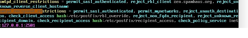

hello
I have some domains that send mail to my domain and their mails blocked by EFA with this error("client host rejected. cannot find your reverse hostname"). I want to add them to the whitelist but, in the /etc/postfix/main.cf when I add this line "check_client_access hash:/etc/postfix/rbl_override," it does not work and I still don't receive those emails. what can I do now? this is a picture of my main.cf file. I attached the file. and the content of my rbl_override is like this:
110.10.2.8 OK
mail.abc.com OK
what's wrong now. I still don't receive these emails
Please help

Re: help about main.cf
You are on the right track, but you are modifying the wrong setting in main.cf
smtpd_sender_restrictions is what you need.

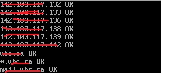

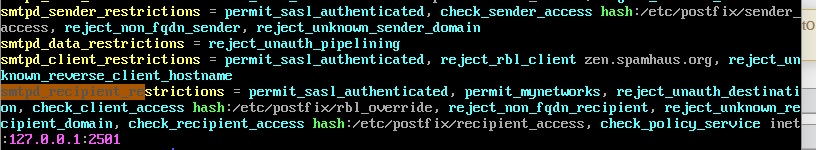

I did it but I still have a problem in receiving mail from those domains. I changed the main.cf like this
(attachment untitled1) and I changed sender_access and rbl_override like this(attachment untitled2)
