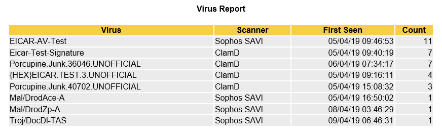

How did you add Sophos SAVI on Virus report? It’s not showing up in scanner column.

Nothing done in virus report, if you dont see i suppose you havent received viruses detected by savi at now

It's not catching test virus 'EICAR-AV-Test' on the report.

EICAR CATCH is excluded by report, you need to include it modifiyng source or wait to receive virus

Okay, thanks. Waiting for virus :)
