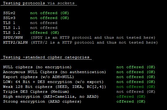

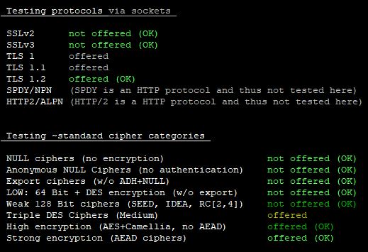

I used
testssh on a kali box to test:
Hope this helps someone
ElFranko

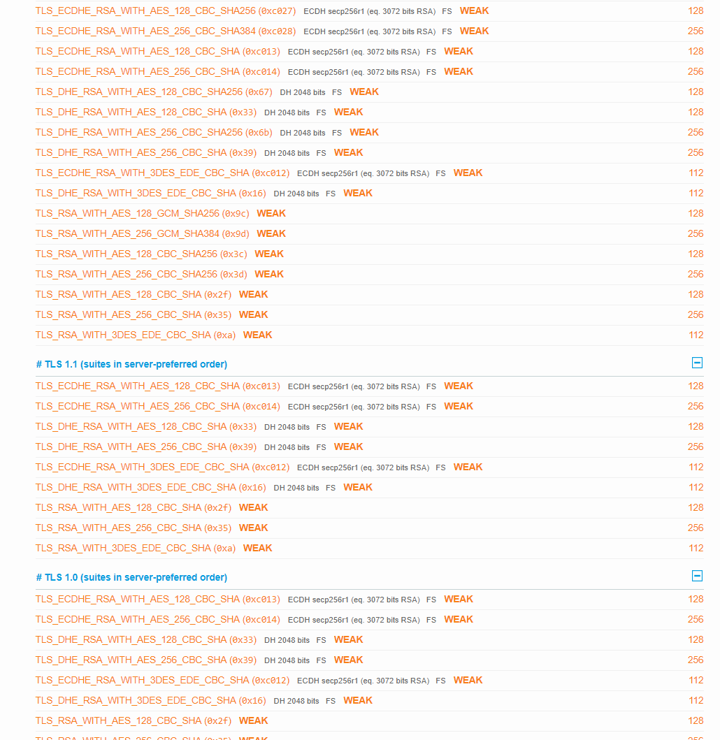

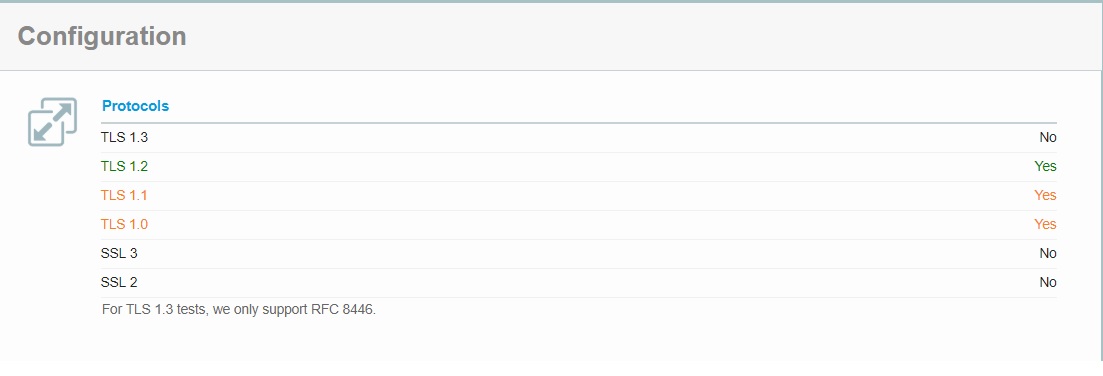

i have followed elfranco steps to disable tls 1/1.1 unfortunately its not disabled
see attached screenshot
i am on EFA 4 maybe this different?

Just checking, is that for disabling SSL etc on the website, what were you using to test. The information I posted was just for disabling the protocols on port 25 (Postfix)
I used a linux script called testssl to check https://testssl.sh/ and https://www.ssllabs.com/ssltest/ for testing websites
Henk's post does them for https and includes how to install testssl
Cheers
