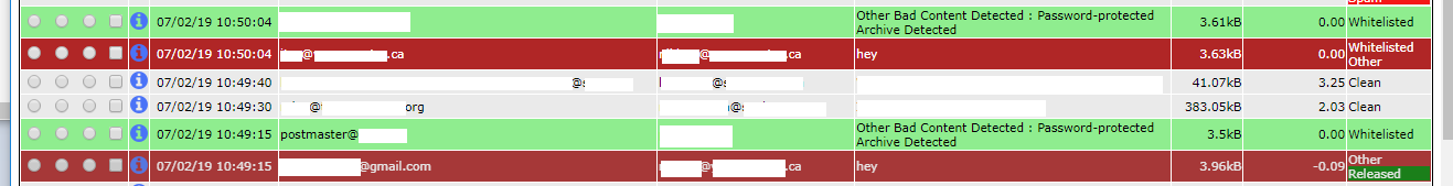

Hey,
Incoming password protected archives are automatically blocked which isn't a problem but we never receive the released message after *successfully* releasing them in mailwatch. The message doesn't show up in exchange server logs either. I also noticed that the "from" field gets changed to my email address instead of being kept as the original sender.
