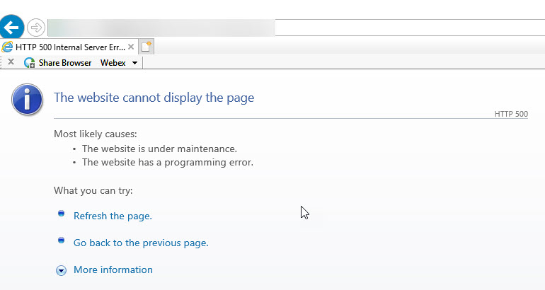

The issue I am having is after making the LDAP changes in the conf.php file, I am able to get a the mailscanner login screen, but with any log in credential (local or AD based), I get a http 500 error.

here is a screenshot of the error as displayed:
if i disable the LDAP everything works as expected, and i am at a complete loss.

[Fri Aug 31 07:29:21 2018] [error] [client 10.100.1.151] PHP Fatal error:  Call to undefined function ldap_connect() in /var/www/html/mailscanner/functions.php on line 2873, referer: https://efa.ghataura.com/mailscanner/login.php
[Fri Aug 31 07:32:56 2018] [error] [client 10.100.1.151] PHP Fatal error:  Call to undefined function ldap_connect() in /var/www/html/mailscanner/functions.php on line 2873, referer: https://efa.ghataura.com/mailscanner/login.php?error=baduser
Re: How to integrate E.F.A 3.0.2.5 with Active Directory (windows 2012 r2)
Looks like you are missing php-ldap. try installing it.
sudo yum install php-ldap
