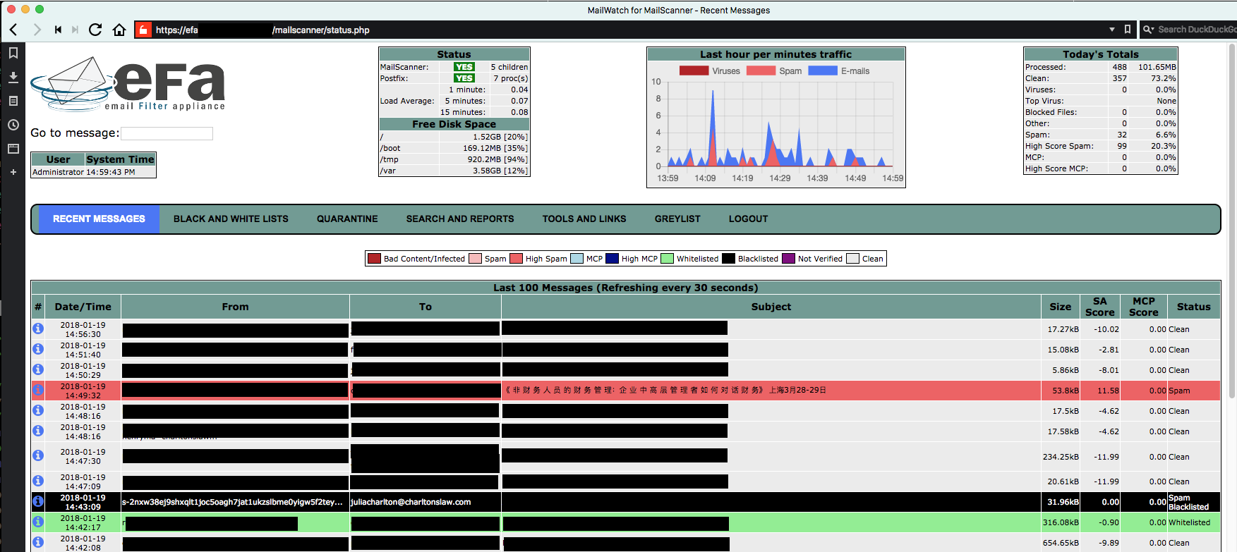

Re: Disable spam check outgoing email
Posted: 19 Jan 2018 07:13
Two screenshots
1/ the /mailscanner/status.php page showing an email that should be whitelisted but is not.
2/ next, show me the message details page at /mailscanner/detail.php that appears when you click on the blue circle with the i inside
3/ then show me your whitelist settings under /mailscanner/lists.php so I can check your settings against what appears under the status.php page.
In the above screenshot, I've whitelisted all mail from the ip address of the exchange server. (all users send mail to the exchange server, exchange server sends it to efa, efa sees it is whitelisted and just sends it out).
Actually, now that I think about it, I think I'll remove the whitelisting and instead use spamassassin to recognize these messages and score them with a -4.0 or something - just in case the users do something stupid.

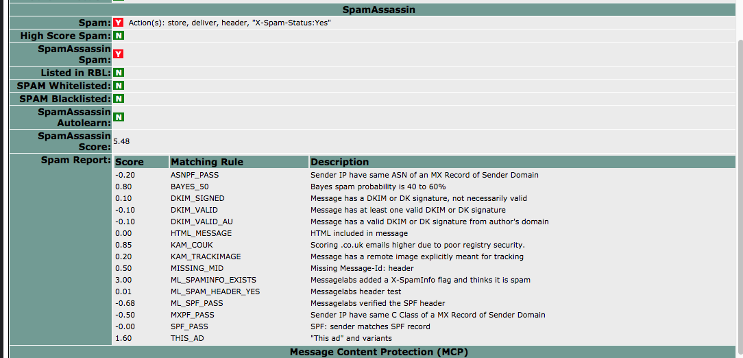

Posted: 12 Mar 2018 10:41
If you go into the message details via the https://<your efa server>/mailscanner/detail.php?<blah blah> link, you'll see something like this:
(image clipped to only the important section)
Screen Shot 2018-03-12 at 18.35.png (146.15 KiB) Viewed 22815 times
It's the above spam report that I am interested in seeing.
Also, I noticed that your blocked line is pink, rather than a darker red. On my system, that means that the spam is only considered likely spam, and I let it through, as opposed to the higher scoring spam which I do block.
So, can you also get me the current settings of the following mailscanner settings in your /etc/MailScanner/MailScanner.conf configuration file? (the values are the settings on my system)
Required SpamAssassin Score = 4
High SpamAssassin Score = 7
Spam Actions = store deliver header "X-Spam-Status:Yes"
High Scoring Spam Actions = store header "X-Spam-Status:Yes"
Non Spam Actions = store deliver header "X-Spam-Status:No"
