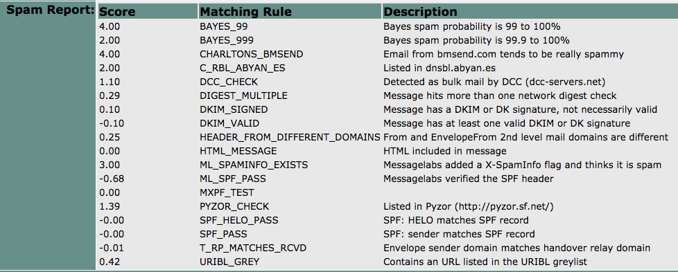

Re: RBL check question
Posted: 11 Dec 2017 04:07
logs? Normally, no. You'll just see the results in the spam report, like so:
Screen Shot 2017-12-11 at 12.00.png (145.23 KiB) Viewed 7713 times
Notice the "dnsbl.abyan.es" which is one of my rbl checks
If you want to see the actual results of the check, you'll have to run spamassassin in debug mode. For the above message, I ran this command to get the debug log:
spamassassin -D -t < /var/spool/MailScanner/quarantine/20171211/spam/58C82180714.A383B 2>&1 |vim -
Search for "DNSBL" or "rbl", or just browse through the entire verbost log to see what is happening.
