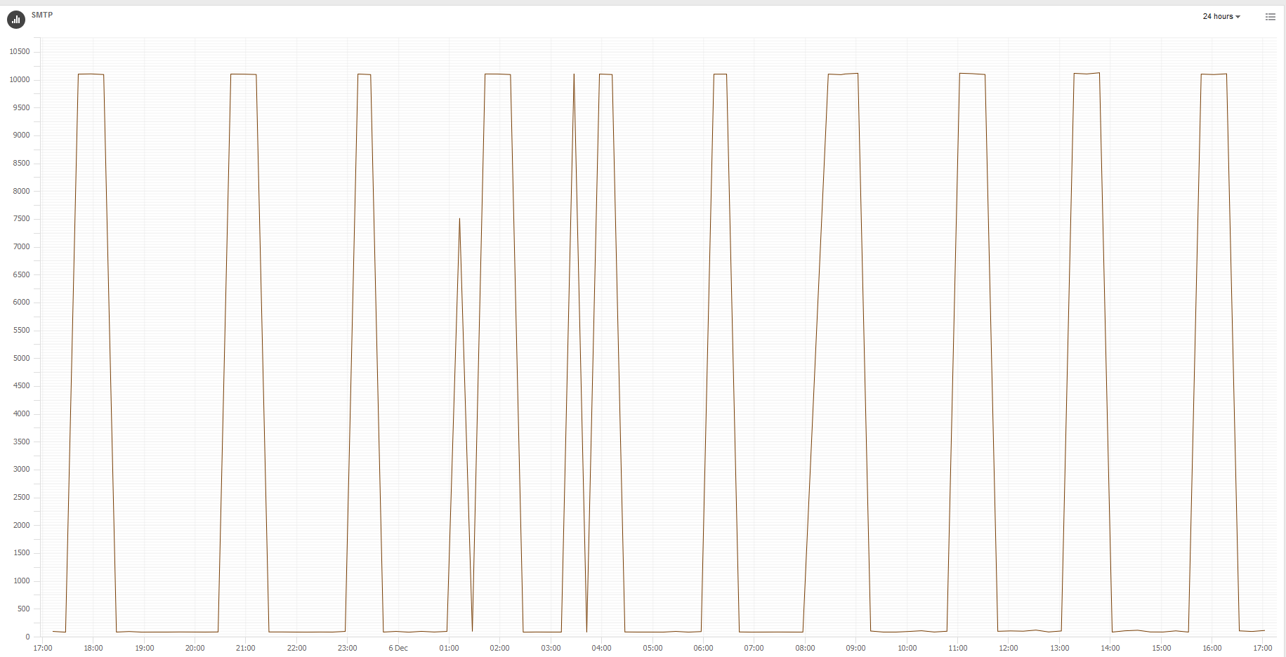

I am currently in the process of setting up eFa in our environment.
It works great so far, but I have one issue regarding our external monitoring software.
After a few requests from our monitoring software it shows that the response times spikes for a period of time.
Could this be a feature of eFa or postfix, which delays the requests if to many invalid/incomplete connections are detected from an IP?
Our monitoring software only connects to the servers sends a helo, waits for the response and then closes the connection.
Hope someone can tell me if this is indeed a feature as the spikes seem to not be completely random.
Thanks in advance
Paul

How are you testing?

the tool opens a SMTP connection on port 25, the delay occurs at this point, only after ~10 seconds I get the first answer from the server.
I checked the maillog and there I can only see the client after the 10 seconds.
Is there another log which tracks connections, that I could check?

And where are you running the check from? Same machine? Remote machine?
If it is a remote machine, how many ip addresses are you connecting from?

Also, can you log the full test session, or tell me exactly how you test port 25?
Re: Monitoring Software - delayed responses
check is run from an external machine on the internet.
I just connect to the 25 port using any SMTP client, eg, telnet using port 25 or putty using 25.
As soon as I click connect (or press Enter) I see a blank screen for about 10 seconds and then I get 220 response from postfix.
The problem occurs with different external clients.

So, if it is the initial connection that is having an issue, I'd strongly consider there to be some kind of problem between the EFA box and the outside world.
So, I'd look at the route from the internet to the firewall, from the firewall to the EFA box (and every piece of network equipment in between). Is there an IP conflict on your network (not likely, the delays look too regular). Is the firewall doing something funny? Is your EFA instance a VM and the VM host is overloaded during those times?
At first, I suspected that it was the greylisting having an effect, but that wouldn't apply to making a direct connection.
Is there anything in your efa logs, either in your maillog or messages files that might show something funny?
Have you installed any additional software, or changed any security settings in your EFA instance?
In my opinion, there is nothing in a stock EFA instance that would cause this problem. My instance responds (almost) instantly no matter where I connect to it from, as I expect it too.

hello,
I was able to further test the behavior using verbose logging.
postfix can see the connection but for some reason does nothing for exactly 10 seconds, that is too long of a delay for the client and it closes the connection itself.
Here the entry from the session from the log:
As you can see the TCP connection itself is established (10:55:04), but there is no further action for 10 seconds after that (10:55:14).
I did not made any changes after deploying the VM aside from the initial setup.
What is interesting is that other SMTP connections to other Mailserver (Exchange) do not behave this way.
On the firewall, I also changed the portforwarding destination to another mailserver for testing and this did not show this delay.
Which leads me to the assumption that postfix is the cause.
Another thing I noticed is that the problem only occurs with clients connecting from the Internet. Clients connection internal IP addresses regardless if they are in the same subnet as the efa-Server do not show this problem. Connections that need to be routed also go through the firewall.
So it seems that the delay occurs on the smtpd-postfix service, but only if the client has a public IP address.
EDIT:
I should also mention, that the times when these delays occur are not the same for all clients.
What I mean is that Client1 can have the delay at this moment and Client2 can currently connect without delay. After a few minutes Client2 can connect without delay and Client2 has the delay. There are of course times when all Clients can instantly connect.

What are your efa firewall settings?
Do you mean the my firewall in front of the efa or a service installed within the efa appliance?
In front of the efa appliance is a Fortigate Firewall with a simple "Virtual IP" (Portforwarding) setup. No Filters are applied, so traffic is not scanned or filtered.
If you mean a firewall in the efa appliance itself: I have to say that I did not know that there was one installed by default and I have not installed one. If you could tell me what firewall is installed I could check the settings.

In the log there is a line who said: "private/anvil: wanted attribute: (list terminator)"
This looks like postfix is thinking it's under a smtp attack because of a wrong authentication/relay

I tried setting "smtpd_client_event_limit_exceptions" to the connecting client IPs so that the anvil ignores these IPs, but that did not help.
Is there another setting I could try.

After some tinkering I found out that the problem seems to only occur when I expose the eFa using one specific IP.
If I use any other IP in the same IP Range the problem does not appear.
All firewall and VM settings are the same. I only changed the external IP on the portforwarding, I was not able to find an exact reason for this behavior.
I'll just use another IP.
Thanks for the help.
