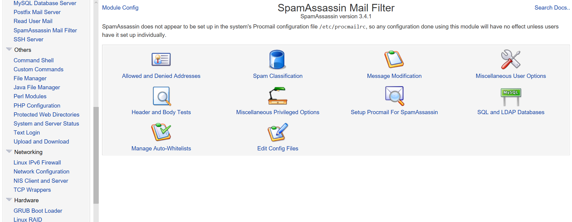

It looks as tho spamassasin is not active

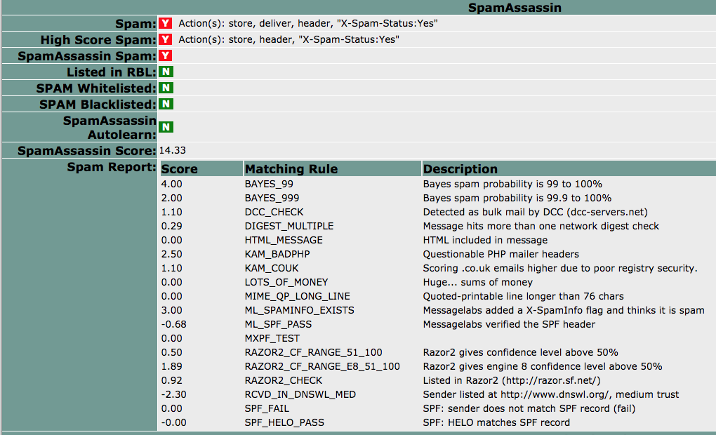

By spam report, I mean the actual report from the message details (https://<efa>/mailscanner/detail.php) , like this:
Screen Shot 2017-10-03 at 09.43.png (199.55 KiB) Viewed 7772 times

Error: unable to validate security token is all I get...I believe spam assassin is not setup??

Still doesn't help.
EFA uses postfix, not procmail. I don't know why your web admin interface gives you that message.
Perhaps you can go back a few steps and tell us how you've installed and then changed your system.

SA seems to be working just fine, in the screenshot I cna see a message scored with 14.33 - what did you set your SPAM limits to? My SPAM limit is 5 and high Scoring SPAM limit is 10. or did I misread that screenshot?
Did you by any chance activate the option for individual SPAM scores? If you do that SA will not filter anything unless you setup all your email users in EFA.
as @pdwalker said: we need way more details about your setup.

Ovizii, that's my screen shot, not escomputer's
