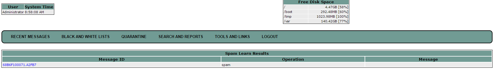

First time posting. This is an odd one. When I select multiple messages from the "Message Operations" screen (for example, multiple spam messages) and then click the "Learn" button, the following screen displays no error, but only shows one message processed (see attached screenshot).
Any ideas on what to check or what would cause this behavior?
