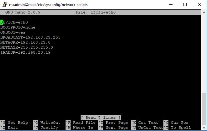

What are the contents of your /etc/sysconfig/network-scripts/ directory in your EFA box? What are the contents of the file ifcfg-eth0, if there is one in that directory.
alexanderbrix
- Posts: 35
- Joined: 20 Oct 2016 06:09
Re: IP address and subnet lost after reboot
here you can see the content of ifcfg-eth0
- 00000.jpg (31.04 KiB) Viewed 19715 times

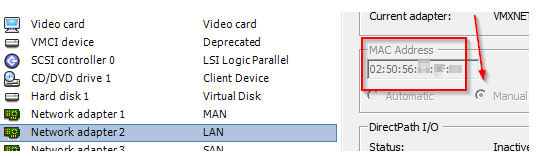

One way to avoid this behavior: you can use manual mac assignment within the virtual machine. Just use some logic to prevent conflicts (duplicates) when calculating the mac address(ses).
To circumvent the limit of 256 virtual network adapters per physical machine and possible MAC address conflicts between virtual machines, system administrators can manually assign MAC addresses. VMware uses the Organizationally Unique Identifier (OUI) 00:50:56 for manually generated addresses.
The MAC address range is 00:50:56:00:00:00-00:50:56:3F:FF:FF.
You can set the addresses by adding the following line to a virtual machine‘s configuration file:
ethernet<number>.address = 00:50:56:XX:YY:ZZ
where <number> refers to the number of the Ethernet adapter, XX is a valid hexadecimal number between 00 and 3F, and YY and ZZ are valid hexadecimal numbers between 00 and FF. The value for XX must not be greater than 3F to avoid conflict with MAC addresses that are generated by the VMware Workstation and VMware Server products. The maximum value for a manually generated MAC address is:
ethernet<number>.address = 00:50:56:3F:FF:FF
You must also set the option in a virtual machine’s configuration file:
ethernet<number>.addressType="static"
Because VMware ESX virtual machines do not support arbitrary MAC addresses, you must use the above format. As long as you choose a unique value for XX:YY:ZZ among your hard-coded addresses, conflicts between the automatically assigned MAC addresses and the manually assigned ones should never occur.
- vmware1.png (12.59 KiB) Viewed 19702 times
Hi Alexander,
On vmware, when setting the mac address, you should use the : 02:50:56 prefix. No idea with MS Hyper-V.
If you are not sure, I would just use the pdwalker solution and remove the manual mac address to prevent strange situations in the future and blame 'someone else'
@pdwalker
I agree that normally this is not the way to go. This happens when you copy or move the vm. The best option is to install EFA from the image provided by efa.
@pdwalker
