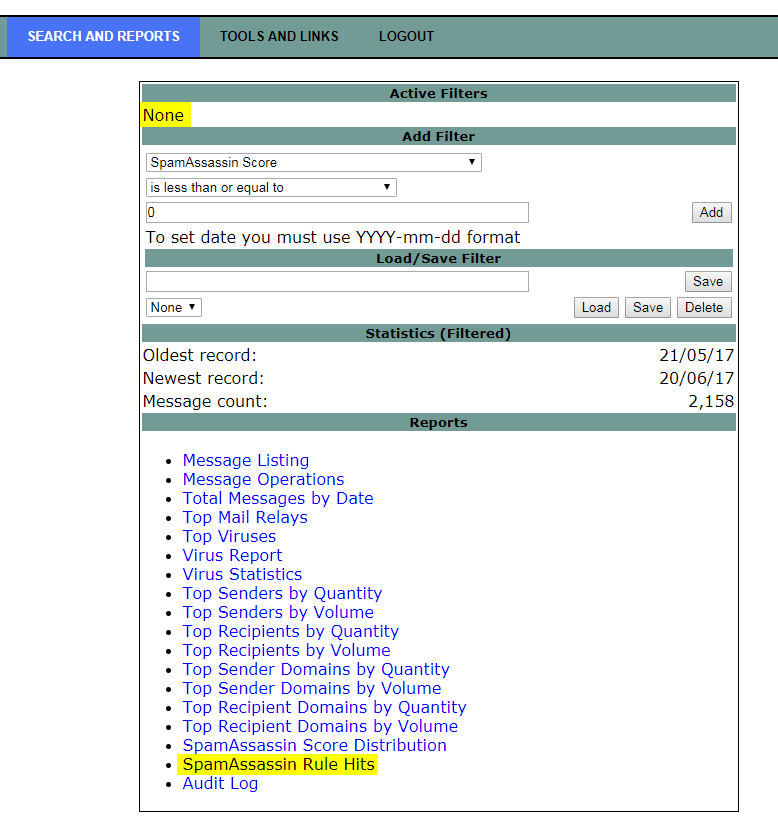

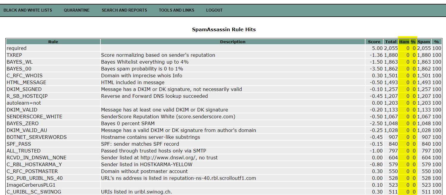

going to EFA web interface => Search and reports => SpamAssassin Rule Hits all I see are rules which hit SPAM, not a single rule seems to have hit any HAM?
Going back to Search & Reports I double checked that I do not have any active filters set. This EFA has been updated step by step from 3.0.1.5 to the current release.
Any ideas?

It's due to a couple of problems in rep_sa_rule_hits.php.
The logic is, look for the string "spam" or "not-spam" and count them up. However, there is no "not-spam" string in the spam report pulled from the spam report in the database.
There is a "not spam" string, but that string is thrown away in the beginning of processing, so the counts cannot be made.
The logic for the spam report string processing needs to be rethought.
/edit/
no, that's not quite right, but the problem is definitely in this file. still debugging.

Ugh,
While the spam report handing is not perfect (autolearn=spam, required, autolearn=not showing up in the report when they should be stripped out), the fix is actually much simpler. Change:
if ($row->isspam !== 0) {
to
if ($row->isspam != 0) {
Search for it and it'll be the first line you find.
Re: My SpamAssassin Rule Hits report is messed up
Posted: 21 Jun 2017 07:43
And just because those "funny" entries appear in the report have annoyed me enough, here is how to get rid of them:
Change
      $junk = array_shift($sa_rules); // score=
      $junk = array_shift($sa_rules); // required
to
      $junk = array_shift($sa_rules); // cached/not cached
      if( stripos($sa_rules[0],"autolearn=") !== false ) {
          $junk = array_shift($sa_rules); // autolearn=spam or not spam, if present
I've not tested it extensively and I might have missed a few cases, but it seems to work.
