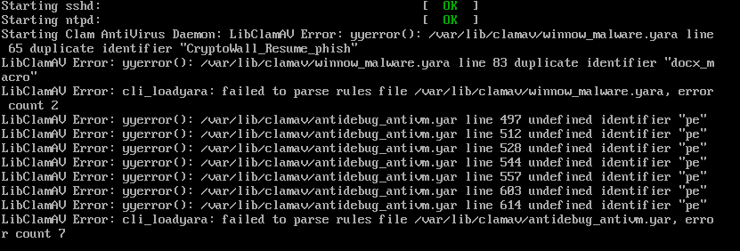

Two things:
1: See the attachement.

Posted: 28 Mar 2017 13:32
#1 Is benign, it is an issue with clamav-unofficial-sigs. You can disable the specific sigs to suppress the errors, if desired.
