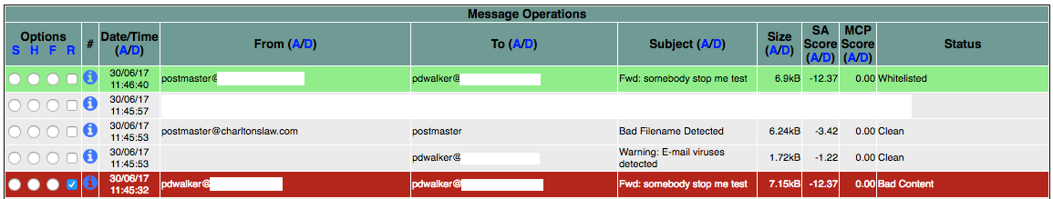

Ok, here was the test I did:
1/ added the following to /etc/MailScanner/filename.rules.conf and restarted mailscanner
# testing purposes only
deny    \.stop\.me    test extension    test extension that efa
2/ send myself a message with the a text file called "somebody.stop.me" attached
as expected, the message was blocked with a status of "bad contact", and my admin account received a message to my inbox notifying me of the blocked message to check
3/ next I went into "Search and Reports, Message Operations" and clicked on the checkbox in the "R" column (for release) and then hit the learn button.
The message was then successfully delivered to my inbox.
So, it does appear to work for blocked content, at least with the settings I have. If you notice, my "postmaster@*" account is whitelisted so the system won't reject the message
I'll next have to test it with a "virus" infected message, and for a message stopped with the MCP.

Re: Unable to release some blocked messages
Posted: 04 Jul 2017 16:55
In my case, yes. You can see the released message from postmaster in the above picture. It came through, attachment and all.
That reminds me, I need to finish the test cases.

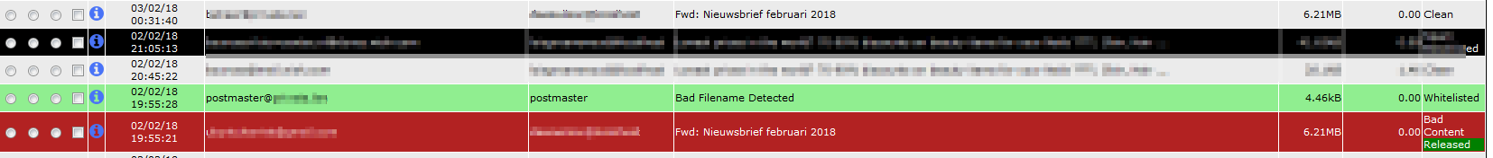

I'm trying to follow your method of releasing blocked content, but no matter what I try, I don't get the messages with blocked content in the list of Message Operations. My EFA appliance is on version 3.27. Do I need extra settings in the MailScanner.conf to achieve this?

I'm unable to release the message, because it's not listed in the SEARCH AND REPORTS/Message Operations list. Further more I can't release the message from RECENT MESSAGES, because there is no release option.
Is there a way to search for messages with Bad Content?
Posted: 05 Feb 2018 15:23
Releasing blocked Bad Content (MailScanner: Attempt to hide real filename extension (xxxxxxxx.docx.pdf)
As admin I can release these messages without any problem, without any additional /etc/MailScanner/filename.rules.conf
See spam actions
Message Listing.png (24.78 KiB) Viewed 48549 times
