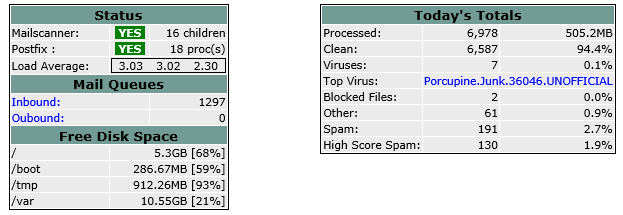

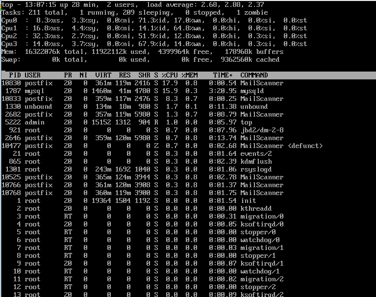

I'm continuing to have issues with messages piling up. Over 1400 right now. Here's system specs:
4 CPU
16GB RAM
8 MailScanner children
no swap
40GB HDD
flushing PostFix queue doesn't seem to do anything.
Not sure why messages won't flow to Exchange.

Posted: 24 Jan 2017 18:06
by tjg88
Re: Strange issues
Posted: 24 Jan 2017 18:07
by tjg88

Posted: 25 Jan 2017 16:51
by tjg88
We moved the VM to a different storage device yesterday afternoon, and the issue seems to resolve itself so far. So, it may have been an I/O issue.
