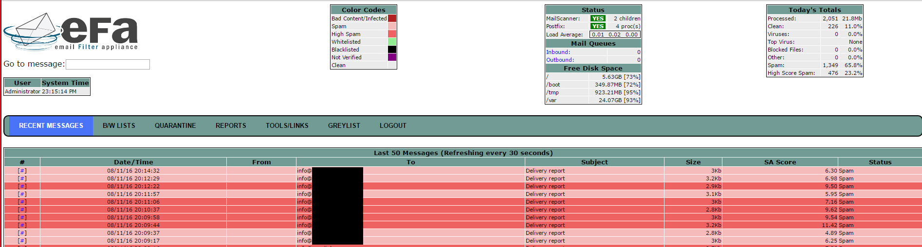

First of all, even tho I am a new EFA user here... I must admit EFA is amazing. The reason I started to use EFA is obviously spam related... Let me summarize the problem and maybe you guys can point me to the right direction.
I started to receive lots of emails from postmaster@domain.com (always a different domain name) with the subject: Delivery report. To stop this annoying spam, this is what I did:
1- After installing and configuring EFA, I forwarded the MX record of the domain that is being spammed to the EFA.
2- As expected, all the emails are being delivered to EFA first, and if they are not spam they come to my inbox.
3- However, some of these postmaster@domainnamehere.com still make their way to the inbox directly....

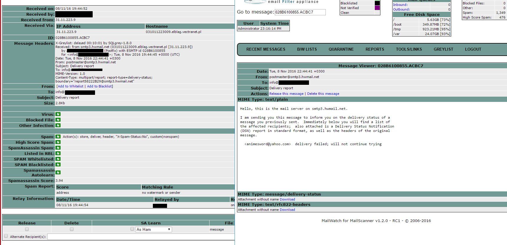

For instance, I attached 2 screenshots to show how bad it is and what I can do to resolve it. Please see the attached(s).
How can I block the emails when the 'from' is empty (as you see in the screenshot)?
Second attached image also shows that empty 'from' email address that is why I can not add to the block list?
I checked the forums and found how to block the emails based on the subject line: viewtopic.php?t=597 -- tried the last post (solution) unfortunately, did not work.
I would appreciate if you guys can tell me how to properly block emails based on their email address - and if email address is not present - based on their subject...
