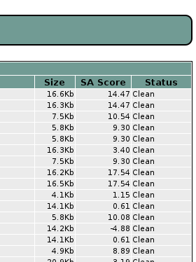

SA Score triggered but shown clean
Posted: 21 Sep 2016 08:29
by denix
example I see 14.47 SA spam score on MailWatch panel but the mail not detect as spam.
Does anyone have an idea?

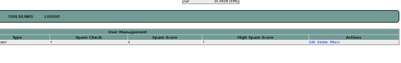

1) Do you have per user mode turned on?
and
2) Are the recipient(s) of those mails defined in MailWatch?
Re: SA Score triggered but shown clean
Posted: 21 Sep 2016 14:37
by denix
Thanks for your reply.
1) Yes. [EFA] Per user scoring is ENABLED
Also i cannot change default spam score
2) I added domain from Transport Settings
Posted: 22 Sep 2016 05:55
by denix
I have disabled Per user scoring and its works as global scoring
Posted: 31 Dec 2016 09:00
It turns out if per user scoring is enabled the user must exist in Mailwatch. I wrongly assumed a per user scoring would check for a differing user score and if not present would use the global score.
Info found here: https://github.com/E-F-A/v3/issues/265
Add an EFA-Configure option to enable this feature. Place a note that any users not in the MailWatch table will not be scanned for spam.
