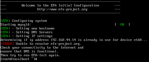

error in EFa-Init due to unbound not being started
Post by SharazJek »
i have experienced this on both the CentOS-buildscript and the .vhd in Hyper-V (but appears to be absent in vmware)
when i started unbound and re-ran EFA-Init, the confguration of the new EFA finally worked.
Re: error in EFa-Init due to unbound not being started
This is an old bug. What version are you building/using?
Post by SharazJek »
it was my friend that downloaded it and i helped him get it up and running over skype, but he downloaded whatever the latest vhd (i assume). i think he downloaded from austria, because the US mirror was unreasonably slow.
