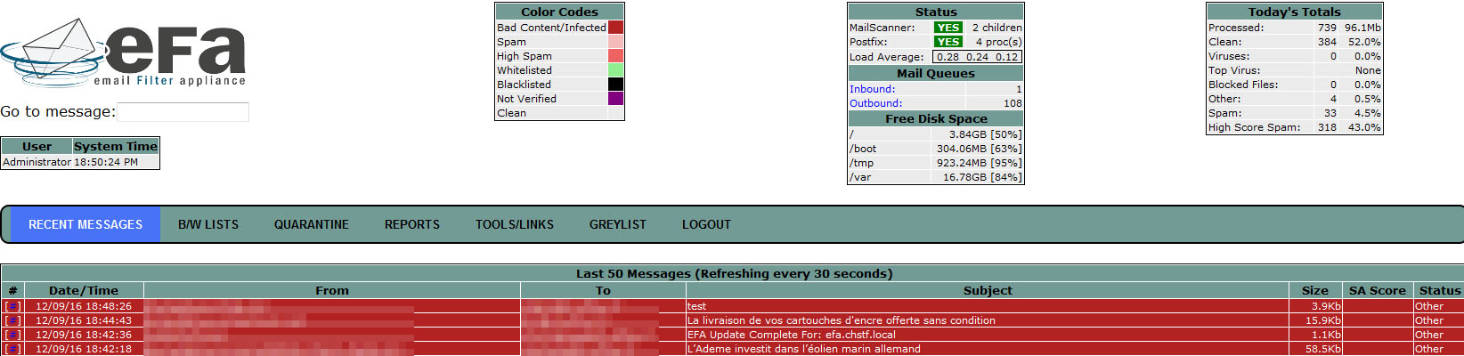

After I've updated my EFA system 3.0.1.1 to 3.0.1.4, I've a bug, all my incomming mails are rejected with status "Others" :
I restored a snapshot :doh:
Have you an idea ? :think:
Thank you.

I think I'd need to see the full headers of one of those messages (click on the #) to get a better idea of why.

With you, I've found the issue.
Reading the new MailScanner configuration file, I saw that F-Prot was not proposed in the AV list :?
By removing F-Prot it's solved.

In the new MailScanner's configuration file (/etc/MailScanner/MailScanner.conf), F-Prot is no longer in the list of compatible antivirus (even if it is still in one example).
