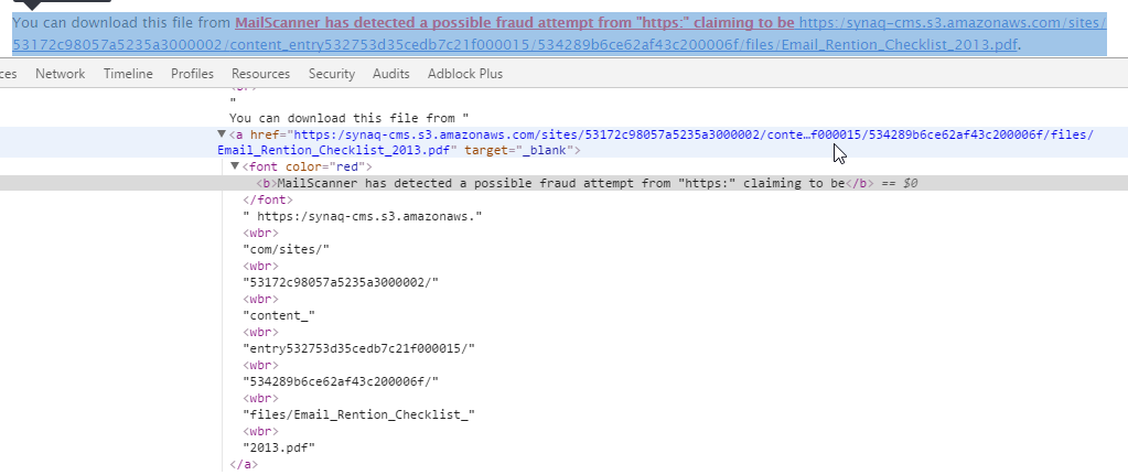

That is a legitimate email btw. It looks like there is a "/" missing in the "https:/"

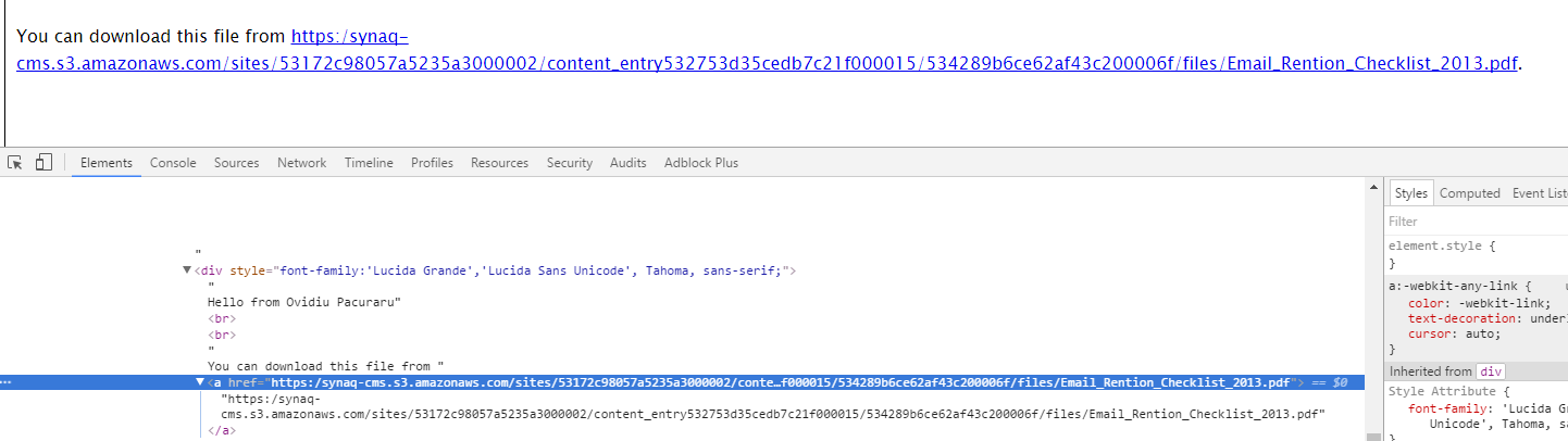

In the email that landed in my inbox after goi9ng through EFA the link looks like a relative link so opening the email in Gmail looks like this:
so the link looks alright but if I click it I end up here with a dead link: https://www.google.com/synaq-cms.s3.ama ... t_2013.pdf
If I go to my EFA dashboard and view the email right there, it looks like this:
and the link inside the email https://myefa.tld/synaq-cms.s3.amazonaw ... t_2013.pdf
So I am trying to understand:
  1. What exactly triggered the phishing fraud warning?
  2. Where can I see the original before the "fix" by Mailscanner?
  3. Does it look like Mailscanner is messing up here or does it look like the link was broken to begin with?
  4. What does this part mean: have disarmed phishing tags
