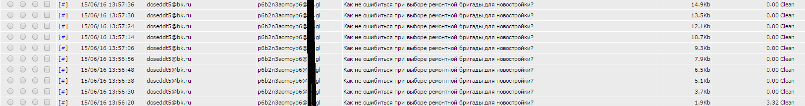

If we set the mx records for domain 3333.gl to ghettosmtp.com, which forwards to us on port 8001, and then we attempt to talk to 3333.gl directly -- just like we do with 1111.com -- we get something like the following:
Starting from the bottom, each iteration going up seems to add a conversation loop like the following:

After about 10 loops, my actual mail host has had enough, and rejects the email.
Further, I tried dynu.com on 8888.com, and the same thing happens.
I don't see why the mail redirection host (in this case, in1.ghettosmtp.com) is talking directly to the end mail host like below:

I'm going to solve this... The final desired destination for mail, huron.MyActualMailHost.com, is using cpanel. When changing MX records, cpanel looks at whether the highest priority MX is on the local system. If it is, it'll deliver locally. If not (as is this case), it treats it as a remote server and has the system do the MX lookup, etc.
If I change the MX record to go through the smtp redirector, then right after I click 'local delivery' in cpanel, all works as expected.
So... that's all.
