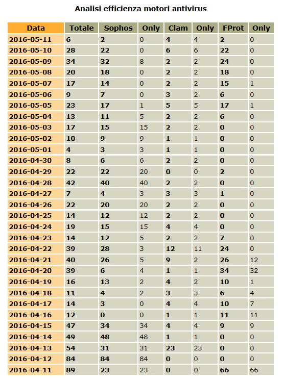

I Installed Sophos in 3.0.0.7 and upgraded in 3.0.0.8
Now i reinstalled in a new fresh 3.0.0.9
I have no problem
I suggest so :
Install a fresh 3.0.0.9 that is perfect version, it have the most stable Centos version
3.0.0.9 have TXREP, with TXREP I have no more false positive without affecting spam detection
With a fresh install you have a perfect functional Clam Antivirus with unofficial extension
Then you must install the only antivirus that works without system modification
Fprot6
Sophos
When you install it you must be careful and specify to not activate automatic system scan of filesystem because you need to use it only to be invoked by MailScanner to scan incoming email files
You also need to modify MailScanner line to invoke these 3 products instead of clam only.
Here my virus detection statistics :
Date Total Sophos Only Clam Only FProt Only
08/04/2016 78 72 22 56 6 0 0
07/04/2016 29 17 17 12 12 0 0
06/04/2016 46 27 27 19 19 0 0
05/04/2016 20 5 5 15 15 0 0
04/04/2016 6 5 5 1 1 0 0
03/04/2016 4 2 2 2 2 0 0
02/04/2016 20 15 15 5 5 0 0
01/04/2016 16 14 14 2 2 0 0
31/03/2016 7 3 3 4 4 0 0
30/03/2016 15 11 6 4 4 5 0
29/03/2016 285 285 167 0 0 118 0
For example 08/04 i found 78 incomingi viruses, Sophos detected 72, 22 was detected by sophos only, Clam detected 56 and 6 only by clam, fprot 0
So if you want you can not install Fprot, but i suggest to install sophos, as you can see
