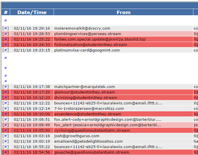

Posted: 03 Nov 2016 00:36
by webguyz
Thanks for the tip about spamassassin and wildcards. But maybe a side affect is I see empty spaces in the Recent Messages list and when clicking on the # side of the empty ones they are from domains I have blacklisted. Do you see the same thing?
Re: Blacklisting A Tricky Sender
Posted: 03 Nov 2016 16:55
by webguyz
Turned out the problem was a CSS issue. Class 'blacklisted' showed white characters on a white background.
Looks ok after I tweaked it.
