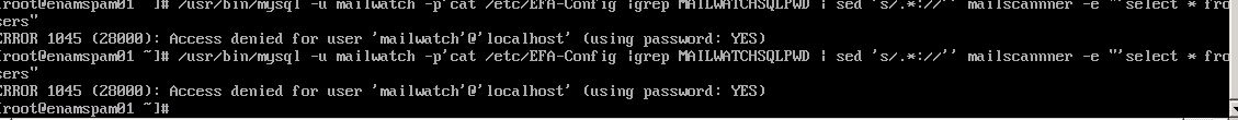

alkarakiomar
- Posts: 6
- Joined: 31 Mar 2015 09:52
Re: Web interface username & password
Thank you for you reply but still not working
I use the below command exactly , and I add ' before admin
/usr/bin/mysql -u mailwatch -p XXXXXXXXX mailscanner -e "UPDATE users SET password = md5('XXXXXXX') WHERE user='admin'"
but when i press Enter it will give me" the attached file "
and when I re-login to Web interface it's fail login.
Thank you for your support
- error.JPG (50.82 KiB) Viewed 116738 times

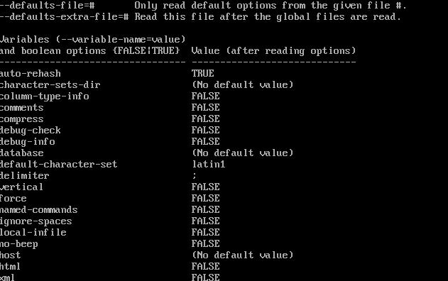

alkarakiomar
- Posts: 6
Dear Dark83
Kindly note that i run that command but nothing change still i cannot access the web interface.( Checked the attached file error_2).
could you please advice me , what shall i do , and as i told you that i have the root password, but my problem only when that i cann't access the web interface. ( error_3)
waitting your advice.
Thank you
Thank you
- Error_3.JPG (33.11 KiB) Viewed 116712 times
- Error_2.JPG (36.64 KiB) Viewed 116712 times
Are you sure your username is 'admin'?
You entered the username during the initial setup, so if you entered something else then you need to use that username instead of 'admin'.
(also you forgot the backticks (`) so the command you entered does not work.
First try to get a list of your users with the command:
This should output atleast 1 row that contains an username.
/usr/bin/mysql -u mailwatch -p`cat /etc/EFA-Config | grep MAILWATCHSQLPWD | sed 's/.*://'` mailscanner -e "select * from users"Version eFa 5.x now available!

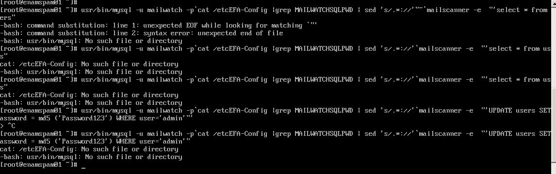

alkarakiomar
- Posts: 6
Appreciate you support first of all.
but my friend i run the command so many times, and i got a new error ( check the attached file ).
i don't know what shall i do now,k because i fed up
Waiting your feedback
- error_4.JPG (34.64 KiB) Viewed 116704 times
Do this first
You should get one line back that looks like this:
If you do, type in
it will succeed or fail.
if it fails, do this
You should get back a line like
if you do, type in
If either mysql command works and you are connected to the database, type in this
post those results
Warning: do not post your passwords. We only need the results of the final query, or the results from the mysql command if they both failed.
cat /etc/EFA-Config |grep SQL|grep MAILWATCHSQLPWDwhere XXX...XXX is your mysql password.MAILWATCHSQLPWD:XXX...XXX
If you do, type in
mysql -umailwatch -pXXX...XXX mailscannerif it fails, do this
cat /etc/EFA-Config |grep SQL|grep MYSQLROOTPWDwhere YYY...YYY is your mysql root password.MYSQLROOTPWD:YYY....YYY
if you do, type in
mysql -uroot -pYYY...YYY mailscannerCode: Select all
select * from users;Warning: do not post your passwords. We only need the results of the final query, or the results from the mysql command if they both failed.
Hi alkarakiomar
Try the methode pdwalker mentioned,
Looking at the screenshots you have some of the quotes wrong so it is not working the line should be:
Note after the -p it should be a backtick not a quote, same for the last one for mailscanner that is a backtick not a single quote
But try the way pdwalker mentioned, that way you don't have to use the longer command.
/usr/bin/mysql -u mailwatch -p`cat /etc/EFA-Config | grep MAILWATCHSQLPWD | sed 's/.*://'` mailscanner -e "select * from users"But try the way pdwalker mentioned, that way you don't have to use the longer command.

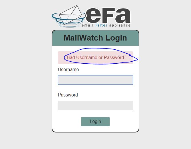

i did a try with
/usr/bin/mysql -u root -p`cat /etc/EFA-Config | grep MYSQLROOTPWD | sed 's/.*://'` mailscanner -e "UPDATE users SET password = PASSWORD('mysecretpassword') WHERE username ='adminefa'"
and now i'm haning with : Bad Username or Password
The password is changed, because the show command show me a other and shorter crypted password ...
Is there a other way, to reset it to the original password ?
i did a try with

mysql -u root -p`cat /etc/EFA-Config | grep MYSQLROOTPWD | sed 's/.*://'` mailscanner -e "Select username, password, MD5('dirkjan') as pwd from users"Code: Select all
/usr/bin/mysql -u mailwatch -p`cat /etc/EFA-Config | grep MAILWATCHSQLPWD | sed 's/.*://'` mailscanner -e "UPDATE users SET password = MD5('dirkjan') WHERE username = 'tempadm'"
Check to see the difference
mysql -u root -p`cat /etc/EFA-Config | grep MYSQLROOTPWD | sed 's/.*://'` mailscanner -e "Select username, password, MD5('dirkjan') as pwd from users"Via Tools and link-> User Management you can change passwords (as user tempadm with password dirkjan is not a secret anymore
