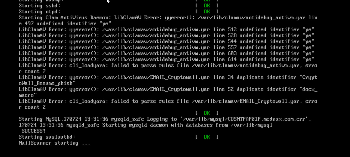

Re: clamd CPu is at 100%
attached is a screenshot of the error when i reboot the server.
- clamd.png (431.23 KiB) Viewed 17700 times

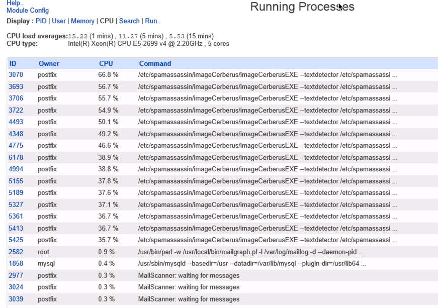

in processes i see like Image Cerberus taking all the CPU. why is this happening? Screenshot is attached.
- 2017-07-24_21-25-25.png (336.57 KiB) Viewed 17690 times

i notice that /imageCerberusEXE is taking all my CPU. What is /imageCerberusEXE? i just use EFA as an internal SMTP relay. Can i just disable it?
imageCerberusEXE is a program designed to "read" graphic images to determine if they are spam, as some spammers use gifs/pngs/jpegs to send spam messages to defeat spam detection software, so it is useful.
Turning it off may allow more spam to come in. I guess that editing /etc/mail/spamassassin/ImageCerberusPLG.cf and commenting out the following line with a "#" character will do the trick:
Unfortunately, in your case, you've seem to have gotten a "special" message that blows up clamd and imageCerberus, so disabling imageCerberus will not stop your problem with ClamD. Or maybe it will if the imageCerberusEXE executable is not running.
Try it and let us know the results. It'll be interesting to find out what is in the message that is causing things to break.
kill those imageCerberusEXE processes and see if the problem comes back.
