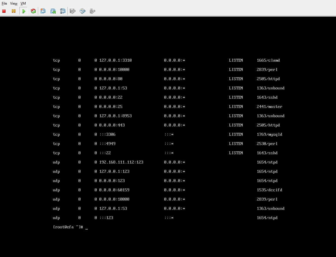

Re: cant login to web page
Can you do me a favour? Post the results of this command (run as root) from your efa box
[root@efa ~]# netstat -plutn
here's mine for comparison:

In particular, I'm interested in seeing the httpd status
dsheetz
Posts: 35
Joined: 01 Jun 2017 17:36
Post by dsheetz »
attached is the output of the command...
