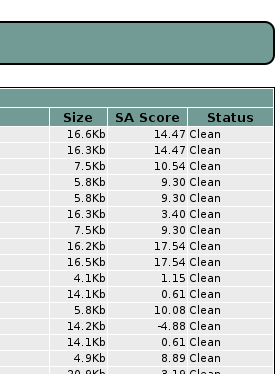

SA Score triggered but shown clean
Post by denix »
example I see 14.47 SA spam score on MailWatch panel but the mail not detect as spam.
Does anyone have an idea?

Re: SA Score triggered but shown clean
Post by denix »
Thanks for your reply.
1) Yes. [EFA] Per user scoring is ENABLED
Also i cannot change default spam score
2) I added domain from Transport Settings
Post by denix »
I have disabled Per user scoring and its works as global scoring
Post by ovizii »
It turns out if per user scoring is enabled the user must exist in Mailwatch. I wrongly assumed a per user scoring would check for a differing user score and if not present would use the global score.
Info found here: https://github.com/E-F-A/v3/issues/265
Add an EFA-Configure option to enable this feature. Place a note that any users not in the MailWatch table will not be scanned for spam.
