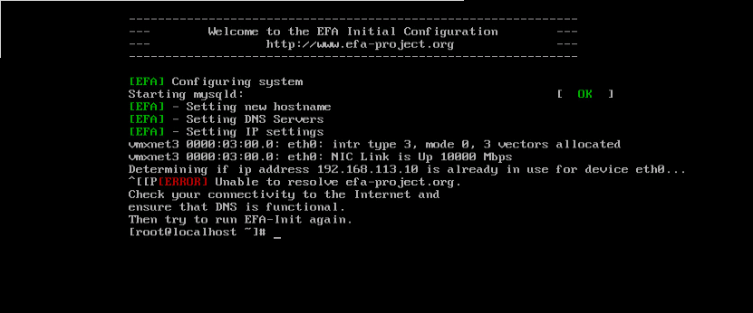

When installing this version on VMWare, after the last "OK", I've the following error : "unable to resolve efa-project".
So, I put the nameserver in /etc/resolv.conf and I launch EFA-Init and then all is ok ....
I think this is a bug in the installation.
Regard

I got the same error "unable to resolve efa-project" during the initial installation.
How do you put name server in /etc/resolv.conf? is it suppose to be a file that i can find somewhere? or you type commands to get there? Please help, as i'm new to Linux...
Re: DNS problem on install with VMWare for 3.0.0.9 version
Here's an easy fix...
type the following:
Hit Ctrl + X and save
sudo nano /etc/resolv.conf
nameserver 8.8.8.8
