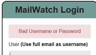

After upgrading to 3.0.1.0, no user from AD can authenticate to the MailWatch login page.
Mailwatch fails.jpg (28.74 KiB) Viewed 8871 times
I've checked all settings, they are still set per all previous AD integration articles; conf.php, functions.php, php-ldap installed, openldap-clients installed, ldpa proxy service account still valid in AD and can login.
