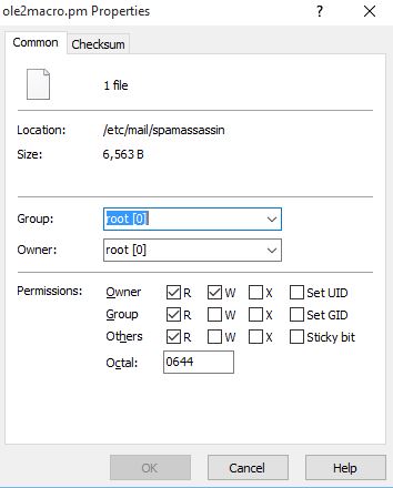

Don't suppose anyone can help -
After completing all steps and running SpamAssassin Lint (Test) the ole2macro.pm is not picked up.
The Ole2macro.pm file is located in /etc/mail/spamassassin/
I have edited the local.cf file to include these line -
loadplugin OLE2Macro ole2macro.pm
body MICROSOFT_OLE2MACRO eval:check_microsoft_ole2macro()
describe MICROSOFT_OLE2MACRO Has an attachment that contains an OLE2 Macro
score MICROSOFT_OLE2MACRO 4

Check the file permissions and ownership of the module. What are they?
What version of EFA?
Re: Help with Custom SpamAssassin Module
Thanks for the quick response
3.0.0.9
Please see attached showing file permissions
3.0.0.9
Only because you caught be just before I was heading to bed.
How did you the file permission properties? Your screen shot looks like a windows dialog box, yet EFA is a linux based system. How did you access the file to get the properties?
Using winscp to login to the file structure
Well, the permissions, ownership and file size matches mine.
I don't think I restarted mailscanner after installing this module, and I don't think it's necessary, but could you restart the mailscanner service? (Do you know how to log into the machine using ssh and run the "sudo service MailScanner restart" command?)
If you can do that, please recheck the spamassassin lint results.
Next, can you tell me where in the /etc/mail/spamassassin/local.cf you added your configuration lines? Specifically, starting at which line number?
Hi pdwalker,
Thanks so much for your help.
I moved the configuration lines to the top of the local.cf file. I originally had it located just above the following line -
'endif # Mail::SpamAssasin::Plugin::Shortcircuit'
Thanks again.
Thanks again.
It should be just below that line, outside of the if/endif blocks.
