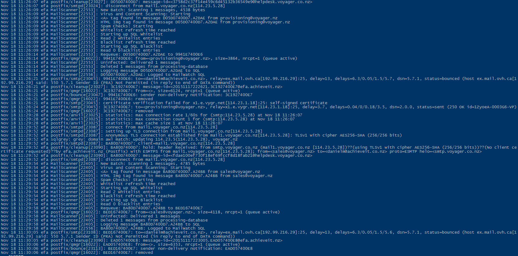

I have attached a capture of my SSH session to my EFA box. These messages were bounced back to the Sender.

Okay...
550 5.7.1 Sender ID (PRA) Not Permitted (in reply to end of DATA command)
This response is coming from your Exchange server. You have Sender ID checking enabled on Exchange. Disable it.

Re: EFA Configuration - Senders receiving bounce messages
Sender ID checking relies on SPF checks of the sender. When you put EFA in line, the SPF check will fail because the email is coming from EFA, not the originator. So yeah, you have a bit of a problem here. EFA needs to be doing the SPF checking, not Exchange.
