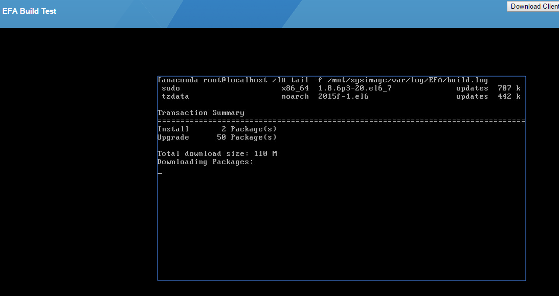

Ok we try again and press alt + f2 to enter the console.
The log at /mnt/sysimage/var/log/EFA/build.log are not exist, if i look at /mnt/sysimage/var/log/ the EFA dir named EFA? also at /var/log the efa dir named EFA?
I check also the installation paths on the server and there have no installations.
/etc/*
no MailScanner folder
no postfix folder
no sqlgrey folder
no EFA-Config file
no EFA-Version file
/var/*
no clamav folder
no EFA folder
no /www/html/mailscanner folder
no /www/html/sgwi folder
I think there is something wrong with https://raw.githubusercontent.com/E-F-A ... build.bash

Thanks for testing shawniverson, i have setup a vps to and it works like a charm :D .
That let me think the bios settings are not right, and after checking the bios setting i see the SATA interface settings are standing wrong on AHCI, i change it tot ATA and the server is installed into 40min.
No BUG into script :shifty:
Problem solved :dance:
