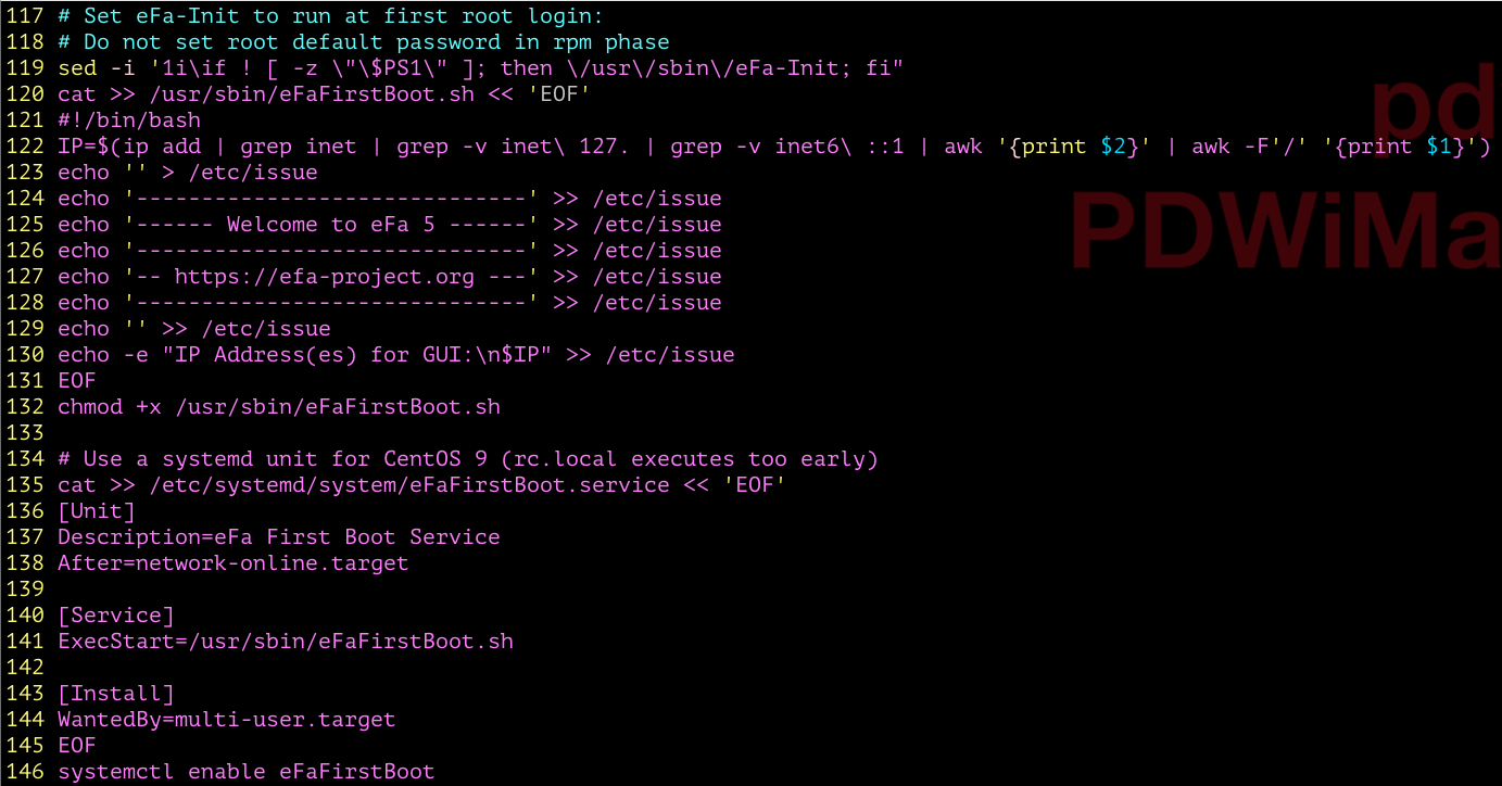

/usr/src/eFa/eFa-config-5.0.0.sh: line 183: unexpected EOF while looking for matching `''
/usr/src/eFa/eFa-config-5.0.0.sh: line 190: syntax error: unexpected end of file

From /usr/src/eFa/eFa-config-5.0.0.sh, I can see the following with syntax highlighting turned on:
Screenshot 2024-07-25 at 13.05.29.png (174.31 KiB) Viewed 48026 times
Line 119 seems to be the issue as the command is not complete.
Edit: From branch 5.0.0-8, the line was previously:
sed -i '1i\\/usr\/sbin\/eFa-Init' /root/.bashrc
Edit 2: I commented out line 119, ran /usr/src/eFa/eFa-config-5.0.0.sh, rebooted and ran /usr/sbin/eFa-Init by hand.

At the final stage of running /usr/sbin/eFa-Init
/usr/sbin/eFa-Commit: line 1066: unexpected EOF while looking for matching `''
/usr/sbin/eFa-Commit: line 1078: syntax error: unexpected end of file
[eFa] - Error initializing system!  Please try again...
That looks familiar...
 919   # Remove EFA-Init from console
 920   sed -i '/^if ! [ -z \"\$PS1\" ]; then \/usr\/sbin\/eFa-Init; fi/d" /root/.bashrc
I commented out line 920 and 921 and reran eFa-Init which seems to have worked. Rebooting...
Edit: rebooted. Everything appears to work as it should.
Re: Error during initial install: unexpected EOF while looking for matching '
Thanks, fixing!
