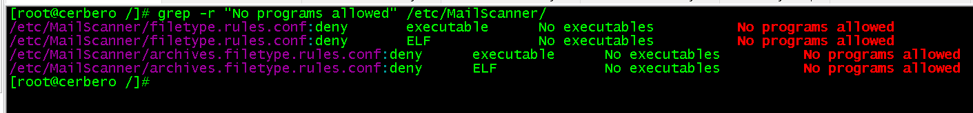

log into your efa box and run the following command from the shell and post the results here.
grep -r "No programs allowed" /etc/MailScanner/-
uzisuicida
- Posts: 12
- Joined: 24 Jan 2019 06:24
Re: Emails that are retained for containing .dat files
Hello pdwalker, here the result of executing that command.
Ok, so that is weird.
I cannot reproduce the problem.

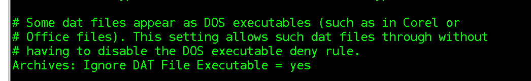

uzisuicida
- Posts: 12
My config is like this:
- Untitled.png (10.28 KiB) Viewed 50613 times
Without the original message to examine, I don't have a solution other than to disable the "No executables" rule inside of MailScanner in the filetype rules configuration files.
