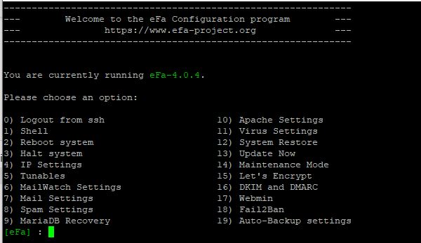

Post by bernikm »
There is no option in efa-config menu to enable STARTTLS ?
We're using efa 4.0.4
freyuh
Posts: 62
Joined: 04 Oct 2018 11:21
Re: Enable TLS 1.3 on efa
Post by freyuh »
It shoult be enough to activate „15) Let`s Encrypt“
