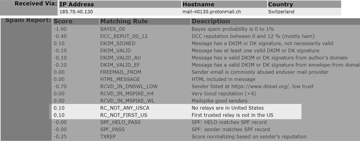

When I send a test email from an account on Protonmail (in Switzerland), mailwatch shows the correct country info, and mailscanner seems to insert the matching mail rules in the spam report:

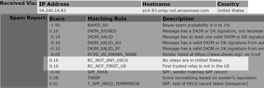

But that's not the case. If the X-Spam-Relay-Countries header is not there, RC_ANY_USCA will be false, and since RC_NOT_ANY_USCA is a meta rule that's simply an inversion of RC_ANY_USCA, then RC_NOT_ANY_USCA will be true. Here is a message from the US, and RC_NOT_ANY_USCA appears.
But Spamassassin is clearly working properly, because it works perfectly from the command line. So the only explanation that makes sense to me is that the X-Spam-Relay-Countries header is not being inserted into the version of the message that Mailscanner is looking at.
