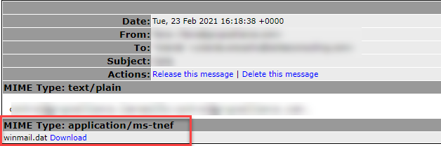

However, my customer receives winmail.dat
When I check the message, I see there is winmail.dat instead of timage001.png and tX_20210223_529.pdf.

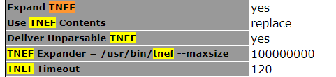

This are my TNEF settings

This is my TNEF module version:
0.18    Convert::TNEF
