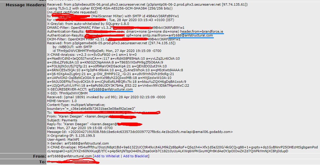

hi all. i have noticed that even though i have the SPF record setup properly for hard fail the spoofed emails still manage to get through.
anything i can do to stop this?

Detail's are your friend. I would recommend posting your dns txt record that you have for spf. And posting a example of where you think spf is not working correctly.

hi
please see below
the ip address is an actual ip address but i masked it
The TXT records found for your domain are:
v=spf1 ip4:154.*.*.* include:spf.protection.outlook.com a:mail-eopbgr40110.outbound.protection.outlook.com -all
also attached screenshot with the email headers
please see below
- spf record.jpg (183.79 KiB) Viewed 28385 times
Re: SPF Not working
I completely understand the need to sanitize, but it's hard for me to follow along with it that way. I don't expect you to trust me, but maybe talk to one of the moderators, and have them look at the unsanitized version so they can help further.
From what I can tell though is spf=none, which is same as accept. So maybe you don't have the txt record in the right place? Should be under the primary domain
