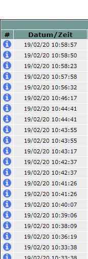

Hello @all,
since 19.02 i cannot see my messages in the webgui. The postfix runs.
I have updatet to EFA-3.0.2.6.
how can I check why?
I hope anyone can help me.
Regards
Stefan
Web GUI no messags listing
- 1.jpg (36.7 KiB) Viewed 61878 times
Re: Web GUI no messags listing
You have 2 options, where option 1 is by far, the best option
1. Update to efa4
2. Enter the next search string in Google, and pick the first [Solved] item on the list.
As a last resort you can use this viewtopic.php?t=3311
Hello Henk,
I have seen this solution, but i did not think this is my solution, i will check it.
I'm sure it is.
To speed up migrations to efa4, I could delete the uploaded GEOIP file.
I will definitely do the update soon...
I have updatet the geoip, but i doesnt can see new messages in the webgui.
Can you describe, step by step, how you updated the GeoIp file?samrein wrote: 27 Feb 2020 20:49 I have updatet the geoip, but i doesnt can see new messages in the webgui.
An old post with isues and solutions for updating from 3.0.2.5 to efa3 EFA-3.0.2.6 viewtopic.php?t=3676
Hi Henk,
I updated the geoip as described in the amount
wget -O geoip.tar.gz download/file.php?id=418
tar -xvzf geoip.tar.gz
cp * /var/www/html/mailscanner/temp/
reboot
I think the geoip is not the problem. They GUI works, only new messages are no longer displayed.
Hi samrein
To be sure there is a GeoIp file in
If not, extract the geoip.tar.gz without a folder structure
/var/www/html/mailscanner/temp/Code: Select all
tar xfz /tmp/geoip.tar.gz --strip-components=3 -C /tmpCode: Select all
cp GeoIP* /var/www/html/mailscanner/temp“We are stuck with technology when what we really want is just stuff that works.” -Douglas Adams
Thank you... but it does not work...
I have restore a backup from the virtual maschine. That works for the moment.
I will migrate to efa4 the next time.
Thank you for your patience and support.
