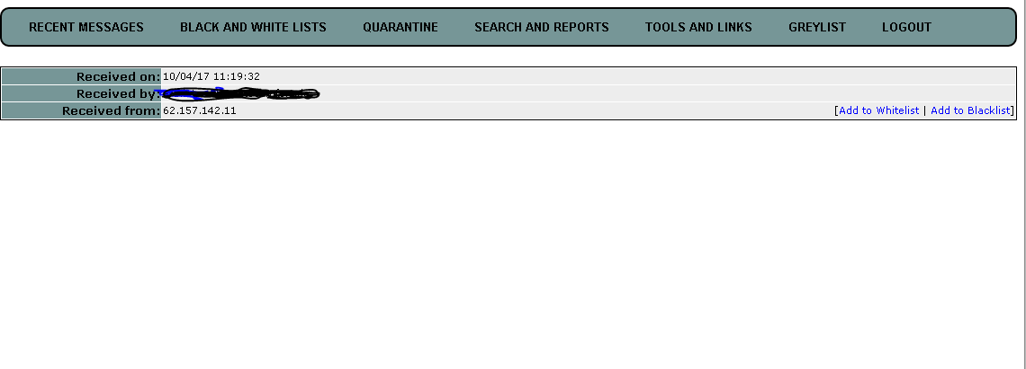

after Update to 3.0.1.9 we have a serious problem: after choosing the message properties we see only this: no properties, no more options.Browser cache also cleared. After an update to 3.0.2 the problem remains. Anybody knows the solution?

a look at tail -f /var/log/httpd/error_log shows:
nc on line 1757, referer: http://192.168.1.6/mailscanner/status.php
[Mon Apr 10 11:55:33 2017] [error] [client 192.168.1.15] PHP Notice: Uninitialized string offset: 1 in /var/www/html/mailscanner/lib/geoip.inc on line 1757, referer: http://192.168.1.6/mailscanner/status.php
[Mon Apr 10 11:55:33 2017] [error] [client 192.168.1.15] PHP Notice: Uninitialized string offset: 2 in /var/www/html/mailscanner/lib/geoip.inc on line 1757, referer: http://192.168.1.6/mailscanner/status.php
[Mon Apr 10 11:55:33 2017] [error] [client 192.168.1.15] PHP Notice: Uninitialized string offset: 3 in /var/www/html/mailscanner/lib/geoip.inc on line 1757, referer: http://192.168.1.6/mailscanner/status.php
[Mon Apr 10 11:55:33 2017] [error] [client 192.168.1.15] PHP Notice: Uninitialized string offset: 4 in /var/www/html/mailscanner/lib/geoip.inc on line 1757, referer: http://192.168.1.6/mailscanner/status.php
[Mon Apr 10 11:55:33 2017] [error] [client 192.168.1.15] PHP Notice: Uninitialized string offset: 5 in /var/www/html/mailscanner/lib/geoip.inc on line 1757, referer: http://192.168.1.6/mailscanner/status.php
[Mon Apr 10 11:55:33 2017] [error] [client 192.168.1.15] PHP Fatal error: GeoIP API: Error traversing database - perhaps it is corrupt? in /var/www/html/mailscanner/lib/geoip.inc on line 1772, referer: http://192.168.1.6/mailscanner/status.php

Are you able to successfully execute a geoip update under tools?
Re: Np data...
Yes:

Double check the permissions on your /var/www/html/mailscanner/temp folder
drwxrwxr-x 2 root apache 4096 Apr 6 07:13 temp

Delete those dat files out of temp and try again.
Re: Np data...
Now I can update GeoIP with no errors, but the main issue persist.
new: I can see some whitelisted messages from root (see attachment) , but not those from from outside senders, also whitelisted.

had the same problem and eventually found this thread, problems started after a GEO-Ip update (never used it before) just deleting the dat files (and not running the update command again) resolved the issue.
