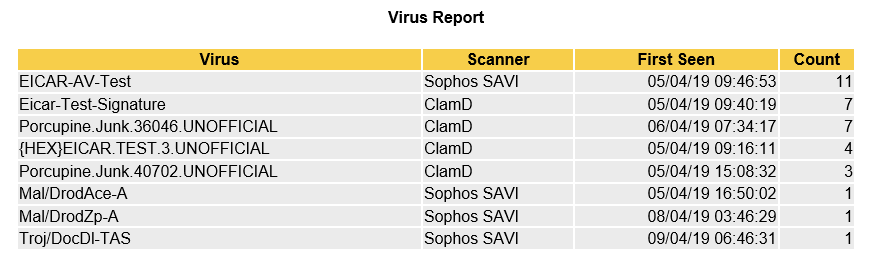

Hi Nicola,
It’s working. Thanks for your document.
How did you add Sophos SAVI on Virus report? It’s not showing up in scanner column.

Post by nicola.piazzi »
Nothing done in virus report, if you dont see i suppose you havent received viruses detected by savi at now

Post by musabr187 »
It's not catching test virus 'EICAR-AV-Test' on the report.
Posts: 389
Joined: 23 Apr 2015 09:45
Re: (how-to) sophossavi installation guide
EICAR CATCH is excluded by report, you need to include it modifiyng source or wait to receive virus
musabr187

Post by musabr187 »
Okay, thanks. Waiting for virus :)
