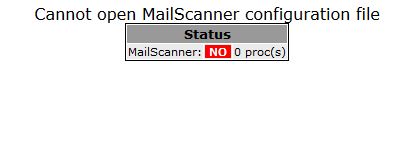

I successfully installed EFA 4 RC 2, but after login to web GUI, i see error message:
Cannot open MailScanner configuration file
see attachment
Re: testing eFa v4 Release Candidate 2
@Glaster
What method did you use to build?
Glaster
Posts: 16
Joined: 10 Dec 2014 21:29
Post by Glaster »
I use: Building using github clone for development
thanks
Glaster wrote: 01 Feb 2019 09:56 Hi,
thanks
Did you restart the environment after building?
Glaster
Posts: 16
Post by Glaster »
shawniverson wrote: 01 Feb 2019 22:49 Did you restart the environment after building?
restart done several times, but the problem persists
logs?
