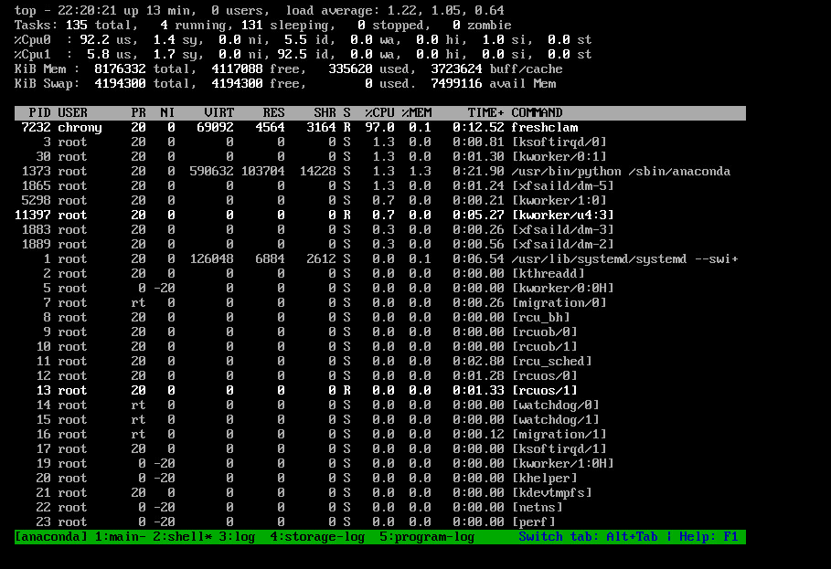

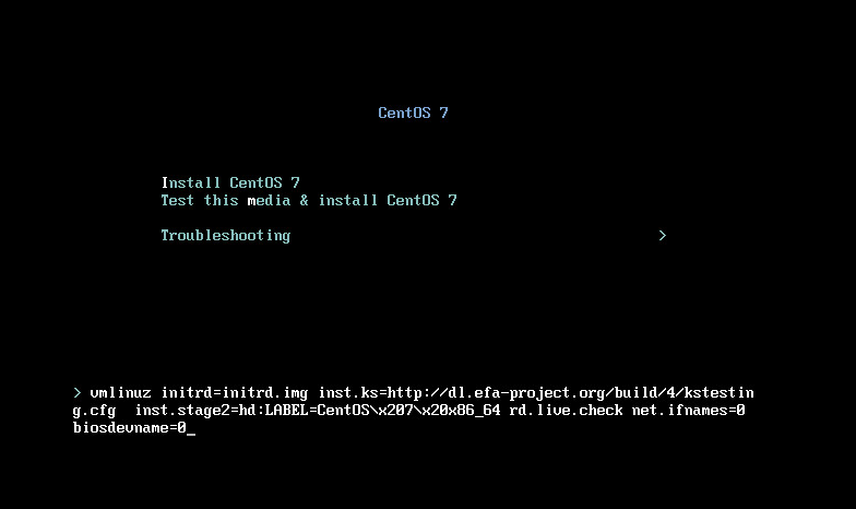

I tested the kickstart again. :violin:
2019-01-20 22_59_50-sanspam_afa on T610.private.lan.png (27.33 KiB) Viewed 3328399 times
Nice to monitor the install with Alt+Tab
2019-01-20 23_20_16-sanspam_afa on T610.private.lan.png (123.28 KiB) Viewed 3328399 times
No issues, just 1 typo at the end

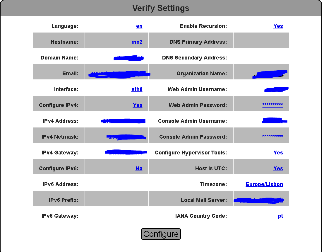

I did not enable IPV6 and enabled recursion.
I did enable rootacces in ssh just for the install to be able to login with ssh. (/etc/ssh/sshd_config)

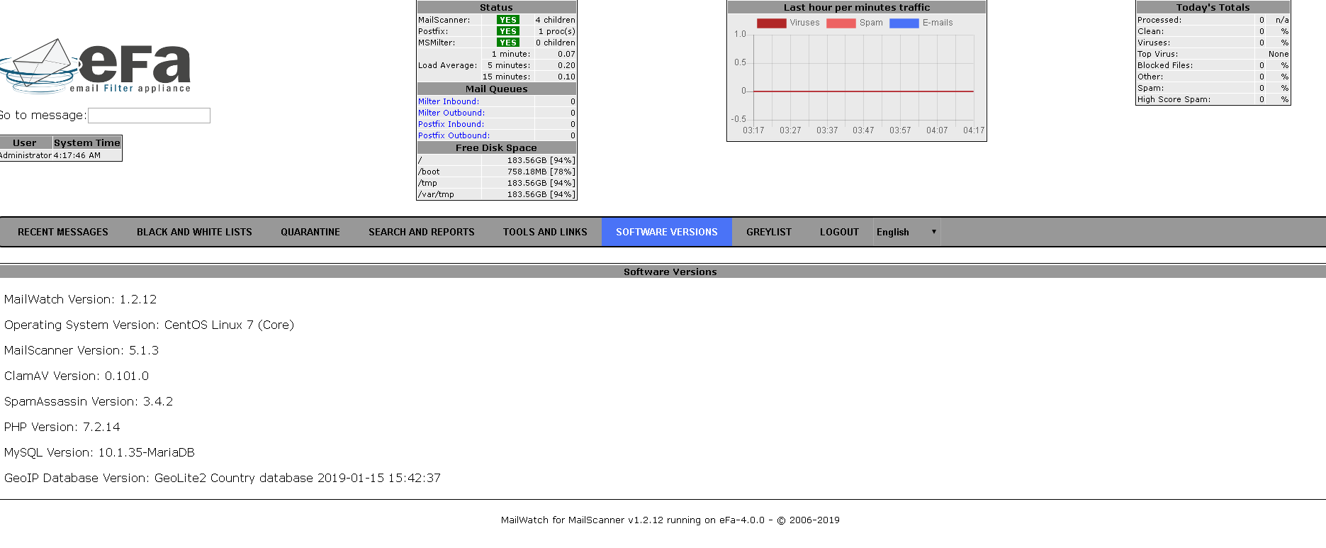

No issue login to Gui. :clap: :clap: :dance: :dance:

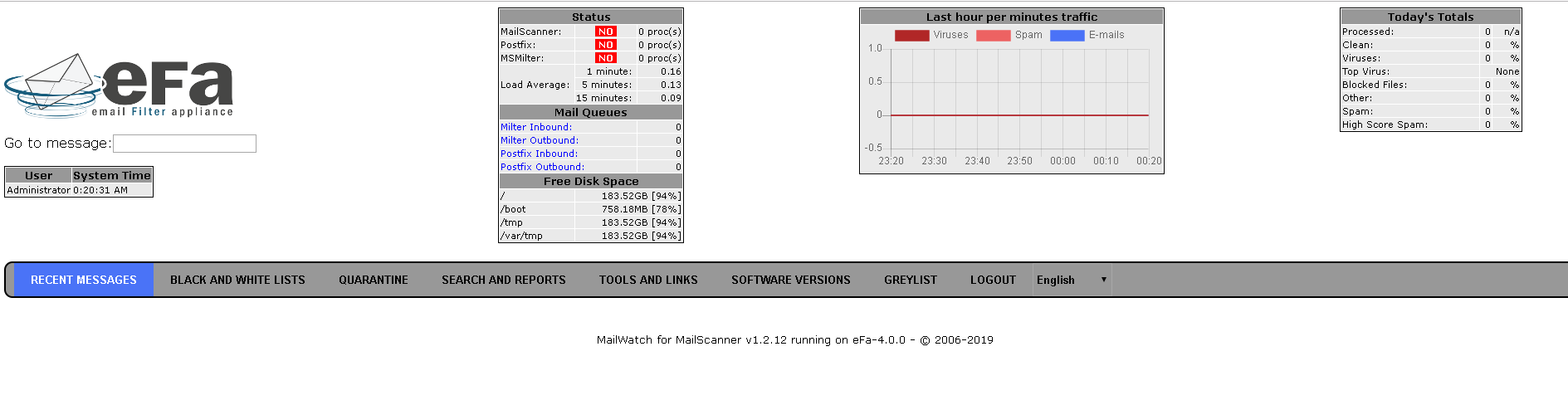

IPV6 disabled and DNS recursion ON
On /etc/hosts
127.0.0.1   localhost localhost.localdomain localhost4 localhost4.localdomain4
::1         localhost localhost.localdomain localhost6 localhost6.localdomain6
x.x.x.x   mx2.domain.tld   mx2
Complete!
s@mx2 ~]$ sudo tail -f /var/log/maillog

Hi Shawn,
1) I confirm that SeLinux was disabled by default on clean Centos 7 on cloud provider - Need to have a check on that on the build;
2) I confirm that on EFAinit (web) I´ve selected "no" for IPV6 - Need to have some check on the build to change the inet if this selection is made;
3) I´ve changed mx priority for testing EFa4 and verify/var/log/mailog and emails are getting in :D
4) SQLgrey is working too

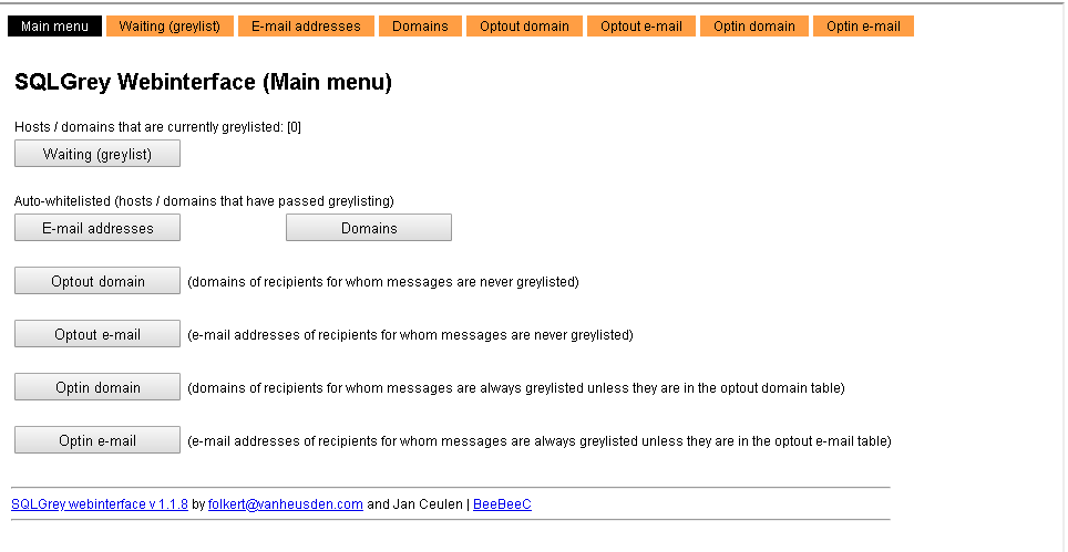

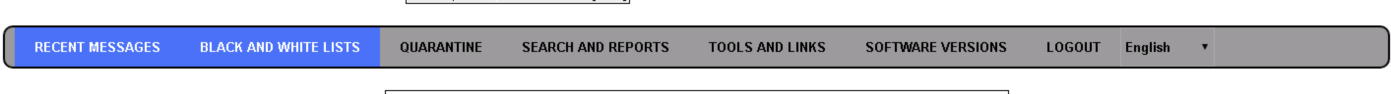

jamerson
Posts: 164
Joined: 19 Aug 2017 18:57
Location: kaaskop
Re: EFA 4 beta
Post by jamerson »
I Dont know what happens but i am missing the button Greylist after today
Emails are arriving no problem, just the button is disapeared.
i've tried to restart the
sudo systemctl start sqlgrey
and even restart but nothing helps.
Schermafbeelding 2019-01-21 om 15.11.28.png (26.36 KiB) Viewed 3328326 times
Re: EFA 4 beta
As we live in different time-zones and some of us need to sleep sometimes, except Shawn.., I did some changes to disable IPV6 today. :)
Unbound is just an example, so you need to modify the ip addresses/network/ Domain mask where used :!:
I still need to check the rpc ipv6, if its needed or not. EFA is up and running (Without IPV6)
disable ipv6 centos7 EFA
REMARK: I use the conventional naming on the interfaces aka eth(x) and not the ens(X) du the net.ifnames=0 boot kernel parameter
do not disable ipv6 in the boot options !!!
reboot when ready !!!
first check ipv6
netstat -tunlp
ip addr show | grep net6
ifconfig -a | grep inet6

Just tried an install of this into a fresh VM using the kickstart file, the install went ok although looks like it shut itself down rather than rebooting when it finished (wasn't watching it sorry). After I powered it on again, it went through the initial setup and looks to be alive & well. I was able to log in via both ssh & the web interface.
Re: EFA 4 beta
:clap: :clap: :clap: :clap: :clap: :clap:
Total download size: 1.2 M
Is this ok [y/d/N]: y
Downloading packages:
Delta RPMs disabled because /usr/bin/applydeltarpm not installed.
(1/2): eFa-4.0.0-5.eFa.el7.x86_64.rpm | 99 kB 00:00:00
(2/2): MailWatch-1.2.12-3.eFa.el7.x86_64.rpm | 1.1 MB 00:00:00
Total 2.1 MB/s | 1.2 MB 00:00:00
Running transaction check
Running transaction test
Transaction test succeeded
Running transaction
Updating : 1:MailWatch-1.2.12-3.eFa.el7.x86_64 1/4
Updating : 1:eFa-4.0.0-5.eFa.el7.x86_64 2/4
Preparing to update eFa...
checkmodule: loading policy configuration from /var/eFa/lib/selinux/eFa.te
checkmodule: policy configuration loaded
checkmodule: writing binary representation (version 19) to /var/eFa/lib/selinux/eFa.mod
Update completed successfully!
Cleanup : 1:eFa-4.0.0-4.eFa.el7.x86_64 3/4
Cleanup : 1:MailWatch-1.2.12-2.eFa.el7.x86_64 4/4
Verifying : 1:MailWatch-1.2.12-3.eFa.el7.x86_64 1/4
Verifying : 1:eFa-4.0.0-5.eFa.el7.x86_64 2/4
Verifying : 1:eFa-4.0.0-4.eFa.el7.x86_64 3/4
Verifying : 1:MailWatch-1.2.12-2.eFa.el7.x86_64 4/4
Updated:
MailWatch.x86_64 1:1.2.12-3.eFa.el7 eFa.x86_64 1:4.0.0-5.eFa.el7
Complete!

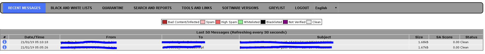

jamerson wrote: 21 Jan 2019 14:54 I Dont know what happens but i am missing the button Greylist after today
I have the same issue, no errors whatsover. Did you also run yum update today?
