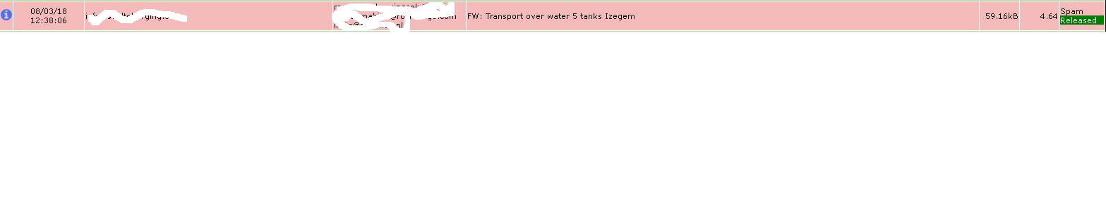

Re: Disable spam check outgoing email
Hi Paul,
i am back with my complain
the internal users are still getting blocked when they send out emails. not always but most of them time.
i've attached a screenshot

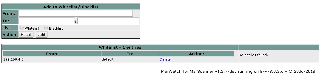

on the whitelist i've added the IP of the exchange ip which is 192.168.4.5 to default see attached screenshot2
As I do not understand your setup, just want to point out that I see IPv6 EX02.domain.comlan ([::1]) and IPv4 EX02.domain.comlan (192.168.4.5). mixed for the same host.
Received: from EX02.domain.comlan (192.168.4.5) by EX02.domain.comlan
(192.168.4.5) with Microsoft SMTP Server (version=TLS1_2,
cipher=TLS_ECDHE_RSA_WITH_AES_128_GCM_SHA256) id 15.1.1415.2; Thu, 8 Mar 2018
12:35:57 +0100
Received: from EX02.domain.comlan ([::1]) by EX02.domain.comlan ([::1])
In the detail section, you can see how the mail is received and the Via Ip's. Can you post a screenshot for this message?
As I do not use IPv6, I don't know if there is a need to whitelist a IPv6 address.
12:35:57 +0100
Stupid question,
How do you know messages are getting blocked? Do you see this in the message log? If so, can you show me a screenshot of that?
I’ll be at a computer in about 8 hours, so I won’t be able to check anything before then.

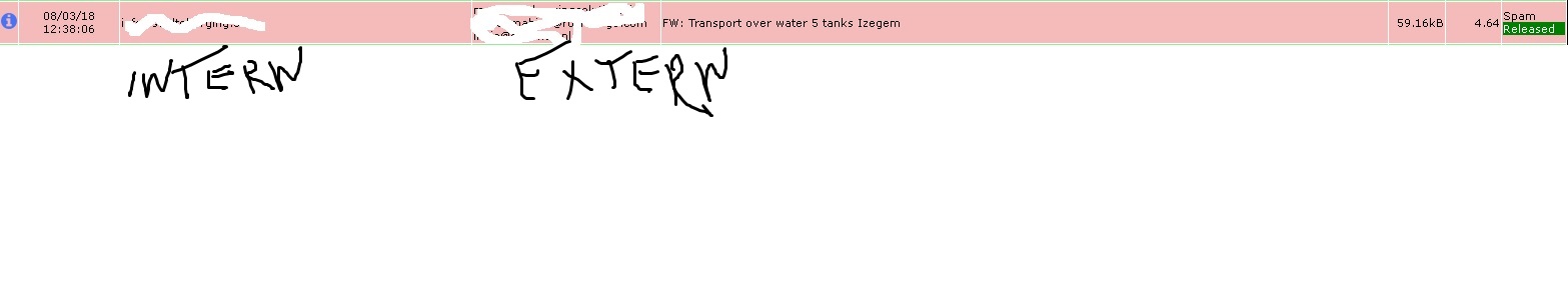

Hi Paul,
i see the email is blocked as showed on the screenshot.
when the internal user send a email its get blocked as the below screenshot
- 1.jpg (40.05 KiB) Viewed 22779 times
the screen of the message is the same as the info above.henk wrote: 08 Mar 2018 13:07 As I do not understand your setup, just want to point out that I see IPv6 EX02.domain.comlan ([::1]) and IPv4 EX02.domain.comlan (192.168.4.5). mixed for the same host.
12:35:57 +0100
i'll attached it again.
do you mean IPV6 could be the issue ?
