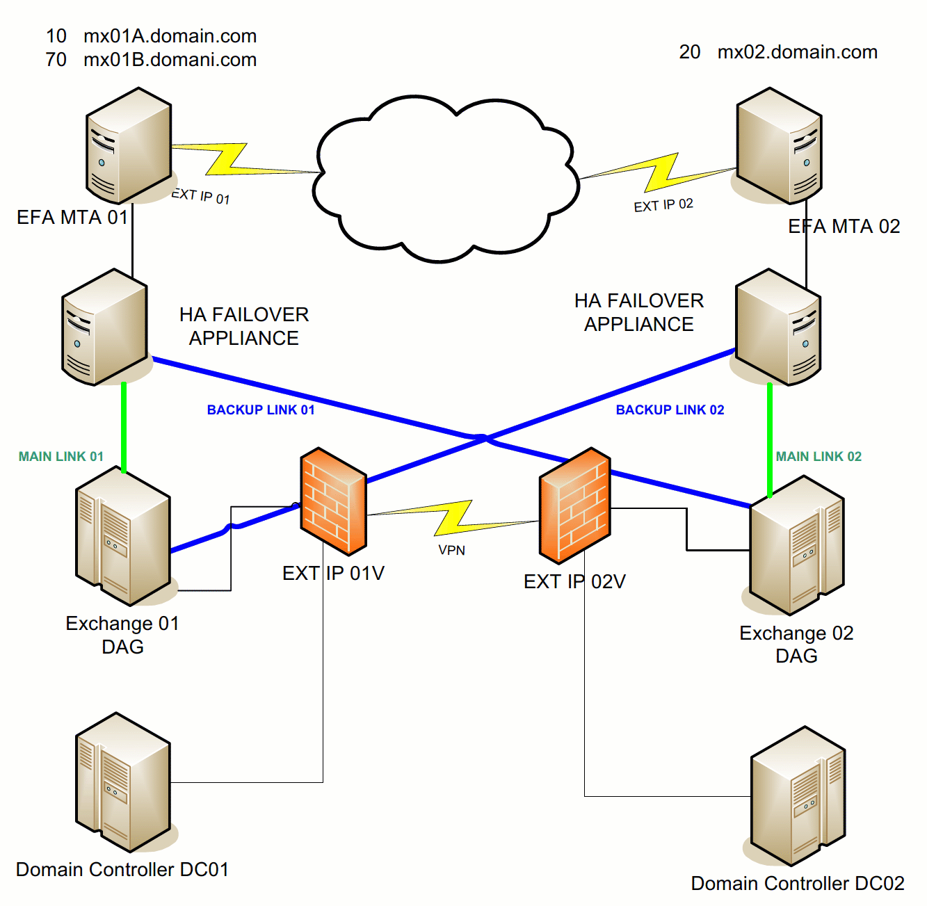

I have no experience using Exchange in DAG configuration, but I would like to test a geographic failover configuration using 2 server far from each other.
Do you think it will possible to realize a configuration as designed in the draw?

Re: exchange server and EFA setting
Getting way beyond EFA here, but yes. Few suggestions/pointers/comments;
As for your other questions;
I use two HA Zevent servers to do that and it works brilliantly. Can't remember the last time I did anything with them.
Good luck!
- Exchange 02 will only ever be good as a DR box. It'll never work for production, if the link goes down the databases will dismount.
It's not a bad thing, that's what my DR server is for. - I'd make 3 MX records, the highest and lowest being EFA MTA 01. Spammers will often hit the lowest record. If the MTA 02 only ever sees spam it'll get so jaded about emails that if you ever fail over to it spamassassin will probably think everything's spam (note I'm not a SA expert but I believe that's what can happen).
- As you've got an even number of Exchange boxes you'll have a witness server somewhere for resolving deadlocks, which you'll have to put in site 01. Whichever site has the witness server will get the majority vote (2 of 3) if the link or VPN ever goes down and that's the site that will remain operational.
- You need a DC in site 02.
- You can have issues with witness servers on DCs (and it's strongly recommended against) so you'll need something that can do file shares in site 01 as the witness server, and the same for site 02 if you ever want to be able to fail over to it.
- Speaking of failing over, if you lose site 01 and you need to fail over to site 02 you'll need to update Exchange to use a different witness server in site 02, then you'll have majority vote for site 02.
Extra tip: Don't think that "alternate witness server" will automatically cover this for you, it actually does nothing until you manually fail over.

Thank for the answer.
You are talking about a "DR" configuration with a "master/slave" configuration or "primary/secondary" approach...
I would like to get an active/active configuration with online DB replica/sync so that theoretically SITE01 = SITE02 in term of functionality.
Is that possible?
Is that possible?
- dag dual mta idea 2.gif (170.35 KiB) Viewed 53433 times
In short it's not possible with your configuration.
I'm assuming Exchange 02 will have a passive copy of the active database on Exchange 01, and Exchange 01 will have a passive copy of the active database on Exchange 02. Users in site 01 will connect to Exchange 01 and users in site 02 will connect to Exchange 02.
With a DAG there's constantly health checks going on between members to figure out the status of the servers and databases. If the private link goes down Exchange 01 can't contact Exchange 02 (and visa-versa) so what does each server do about their passive copies (and their active copies)? Basically they hold a vote to see which site is deemed healthy, which is where the aforementioned witness server comes in. Both servers will have a vote each so it'll be a deadlock, the witness server has the deciding vote on which site is healthy, and assuming it is located in site 01 then site 01 will be deemed healthy. All databases will become active on Exchange 01. Exchange 02, only having 1 out of 3 votes in its site, will declare itself bad and make all databases passive and unavailable.
You'll actually need two certificates for Outlook Anywhere (one for each site). Autodiscover DNS will be configured to hit one of your Exchange servers (presumably 01) and it'll then refer the client to itself or the DNS entry associated with Exchange 02 if the active copy is over there.
I've deliberately always avoided the situation you're proposing so I might be a bit off for this next bit... but if you've got that configured properly then if Exchange 02 goes offline and their copies become active on Exchange 01 the users in site 02 will get updated autodiscover information pointing them to the Outlook Anywhere address for site 01 and they'll eventually come back online. Once the link comes back you can then reactivate the database on Exchange 02 and the users will then start talking back to the local Exchange server.
But as you can see a minor link hiccup can lead to a lot of annoyance. Even communication delays can lead to Exchange doing pleasant things like deciding the cluster isn't healthy (which a DAG uses in the backend) and rebooting the entire server. I love that one. Especially as it does it via a BSOD.
If you truly want active/active that'll survive private link issues then the simple thing is to remove the DAG component. If you want the HA and active/active then it'll probably be four Exchange boxes, two DAGs, two witness servers (one in each site).

I finally got that my scenario with "active-active" database is not available in DAG exchange configuration.
"Within a database availability group (DAG) each database can have one active copy, and up to 15 passive copies at any given time. Changes that occur in the active database copy are replicated to the passive copies by a process of continuous replication. The active copy can be dismounted, and one of the passive copies mounted to become the active copy, when a switchover or failover occurs.
In a split brain scenario, two copies of a database would be active at the same time, mounted on DAG members that are unable to communicate with each other due to a network problem, causing the databases to diverge. This is a situation that must be avoided, because it creates a difficult recovery scenario and will likely result in data loss."
Anyway I started a test ambience to understand the right solution.

I still thinking how to use EFA in a dual (or multiple) site .... not easy....
Simplify it. Take out the DAG component (leaving you with two standard Exchange boxes, one in each site with one database each) and I'd also ditch the HA appliances, I can't really see how that'll help.
Leave the EFA boxes in each site delivering to the local Exchange server. Exchange will know where the recipient's mailbox is homed and push the mail delivery to that box (via your private link if it's a server in another site).
DAG will give you HA but it sounds like you just need an active database in all sites.

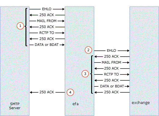

mmmmm
The problem is the cache in EFA...
If the exchange go down, EFA will continue to accept email from SMTP server.
The right functionality should be this one (in the pitcture)
- itpro_transport_shadowmessagingoverview.gif (34.89 KiB) Viewed 53217 times
