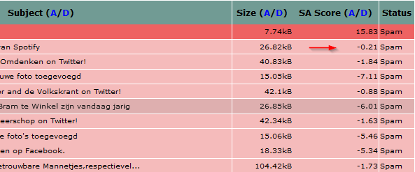

How to check if these changes have any effect?
Define some filters in search and reports.
Now you will see you also catch spam with scores below the defined spam threshold.

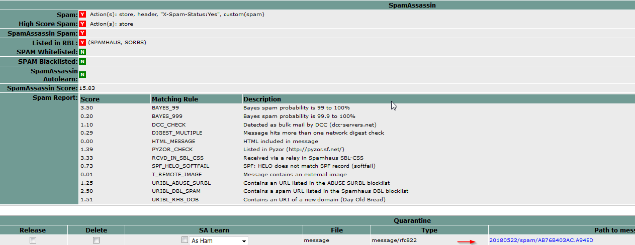

Just select one and copy the filename and run this replacing date and message-ID.
sa-learn -D --spam /var/spool/MailScanner/quarantine/20180522/spam/AB76B403AC.A94ED &> /tmp/henk1.log
In this log there is a lot of info that you can use to check if EFA is working as you think it's is working :shifty:
DNS, trusted networks, untrusted networks, etc, etc. Just take some time to examine the logfile.
