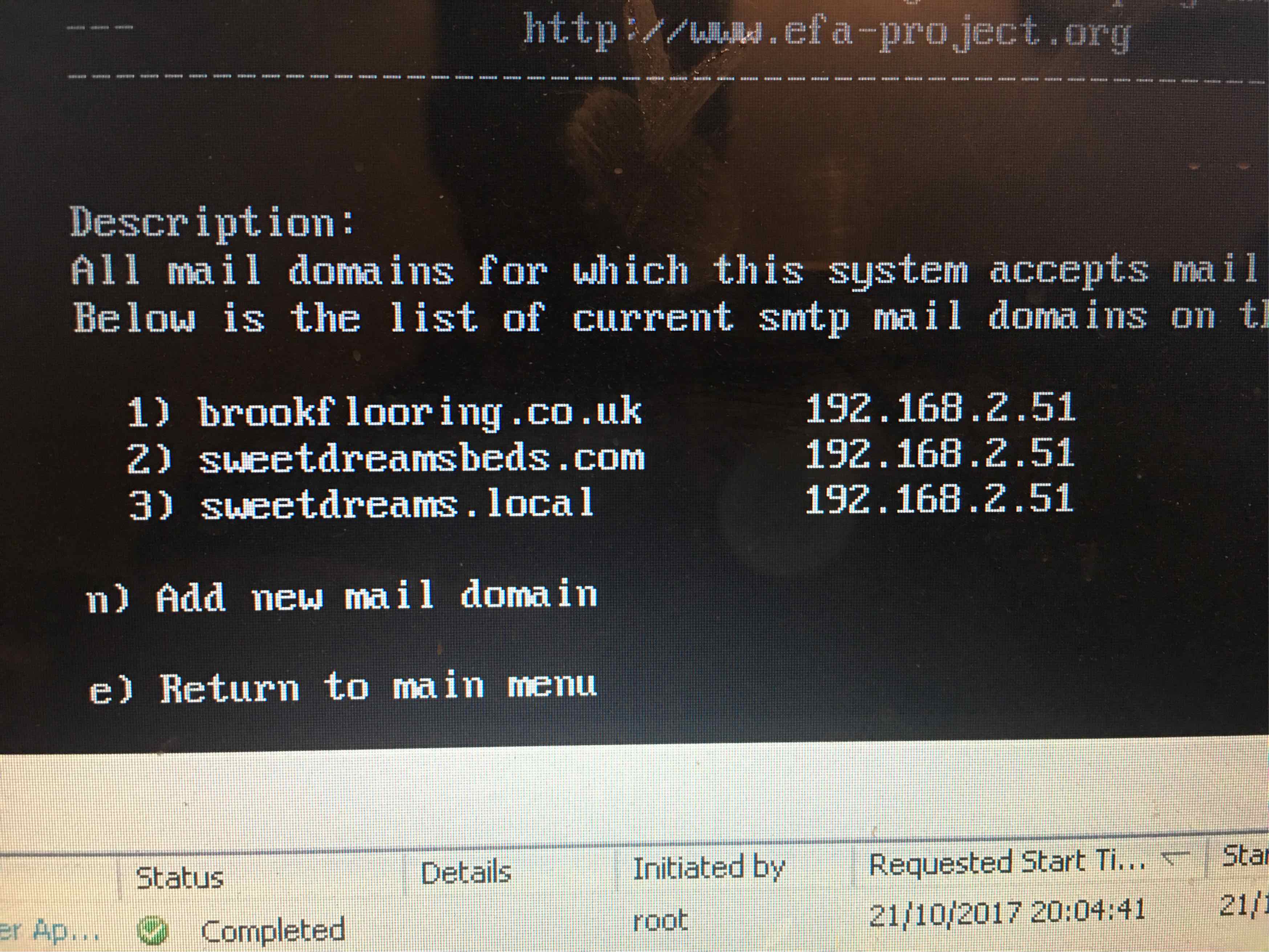

1) Do you have your mail server added to your eFa as a transport destination? Is it correct?
EFA-Configure, option 8, then option 4

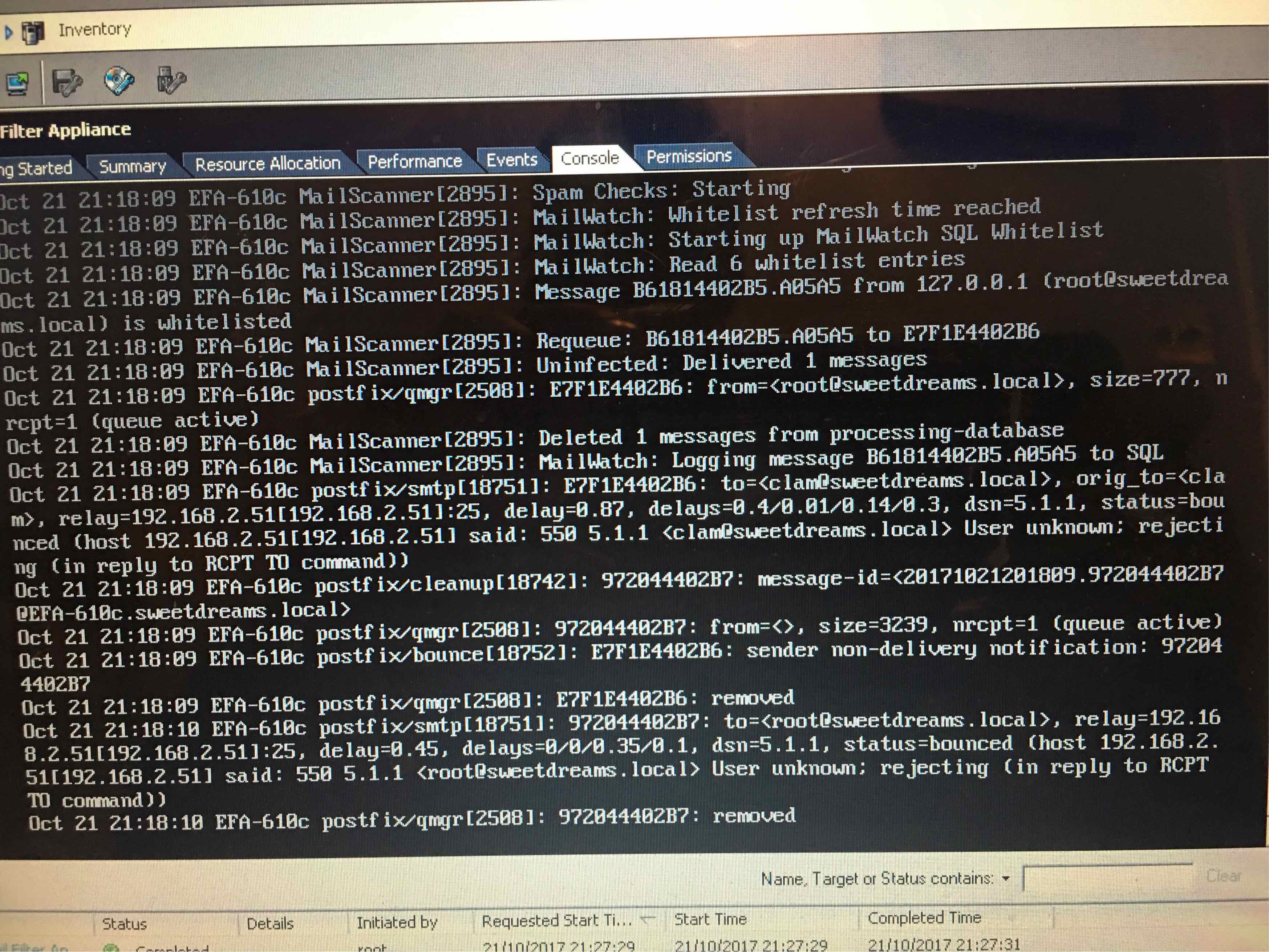

2) Are you seeing the delivery issues in /var/log/maillog ? If so, can you share a sample?

File attachments for transport options and log file
Thanks again for all help offered

Yeah, it appears it is attempting to deliver a message to "clam@sweetdreams.local" which your mail server rejects, then it attempts to deliver an undeliverable to "root@sweetdreams.local" (the from) which also doesn't exist either and is rejected.

I think the clam email is efa generated. it looks like for some reason efa turns every email coming through into a root@sweetdreams.local intended recipient instead of the original recipient. I am struggling to send an email insternally via the mail server as our mail server is designed to recognize internal emails and deliver them directly to the inbox. Not knowing enough about how the efa server parses emails and how it changes the recipients is leading me to a dead end. I retried the xeams server again today directing all emails from our pop collector via xeams to our mail server and all emails cames straight through no problem so the transport network seems ok at least.

Can you provide a maillog of the initial conversation to a recipient? So far I cannot observe this actually happening, based on the logs screenshots your are providing. I am not even sure that your setup is actually relaying anything to the appliance, for unknown reasons. I need to see an actual connection from your pop collector to eFa. Now, the bounces you shared are going to your mailserver because both your eFa and mail server have the same domain name, so postfix is using the transport to deliver to your mailserver instead of local linux accounts on the system. Simply changing the domain name of your eFa can resolve that. But again, those emails are system messages, not actual emails going through the system.phil57 wrote: 22 Oct 2017 07:46 Hi
