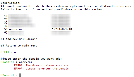

I want to transfer incoming mail to two different servers when a domaine is mailed. Both servers will have the same user account.
For example:
I am sending an email to omer@omer.com.
omer.com mx records find EFA server.
EFA, check the incoming mail. Later incoming mail is delivered to servers 192.168.1.10 (Postfix) and 192.168.1.20 (Kerio).
That's what I want to do.
EFA does not allow you to add the same domain again. I thought he would add the same domain again and redirect it to a different ip address.

Oh, I see.
One copy goes to Kerio and one copy to your mail server.
No, I don't know how to do that.
My first guess would be to send the mail to Kerio and then have Kerio make its copy and then send it onto your mail server.
Could that work?
