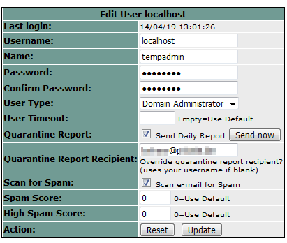

Yes, thanks henk, that is exactly what I meant but the link you posted is a bit confusing as the screenshot does not exactly fit the text you wrote there.
This is what I am confused about:
In previous MailWatch versions we could enter any username in a non valid email format, to generate 1 single quarantine report for all mail-users for a specific domain.
as far as I remember, if I simply entered a domain as username and added an email to that user, that email would receive a quarantine report for that whole domain.
Now if I look at your screenshot, the username is a full email address meaning that user will only receive a quarantine report for that particular email, or am I wrogn here? Shouldn't the username be: @localhost and the recipient email monitor@localhost?

Posted: 14 May 2019 14:04
You did remember well :D
As I use fetchmail to fetch mail form external sources, I map that to a local user. So every mail user has a user@localhost account on EFA. ( also dovecot is running ). The the recipient email is an admin user at my domain (my internal mailserver)
Just succesfull tested the domain only username: localhost
2019-05-14-User Management.png (15.42 KiB) Viewed 25701 times
Result:
/usr/local/bin/mailwatch/tools/Cron_jobs/mailwatch_quarantine_report.php
 === Generating report for localhost type=D
 ==== Recipient e-mail address is test@mydomain.com
 ==== Building list for localhost
 ==== Found 4 quarantined e-mails
 ==== Sent e-mail to test@mydomain.com
 === Generating report for monitor@localhost type=D
