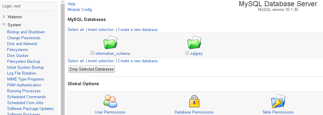

I grabbed the sqlgrey password from /etc/efa-config and was successful in logging into mysql via webmin. So I am assuming that the username and password are configured correctly.

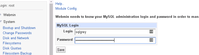

Are you sure about the password being wrong? Because when I grab the password that is in the /etc/efa-config file then go into MySQL via Webmin it accepts that password and lets me in:

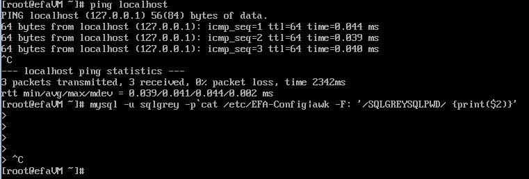

I think I might have a typo in the mysql command line. All it does is open a blank prompt like it's waiting for more input:
I have to press ctrl-c to get back to the command prompt.

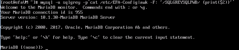

Neat trick - I should have caught that missing backtick as well.
Looks like it works:
